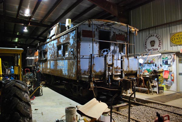

File comment: LV 95100 in the shop, photo by J.R. Nugent
Photo by J.R. Nugent
On January 15, 2012, LV 95100 was placed inside the restoration shop at the Rochester & Genesee Valley Railroad Museum. We are depending on outside donations to complete the restoration work, every little bit helps, whether it is a donation of cash, goods, or time.

The caboose was trucked to our museum on October 22, 2011, and immediately our volunteers set to work to make the car safe for movement over rail up to our restoration shop. An initial investigation of the caboose’s brake system revealed that water had gotten into the pipes, so the brake cylinder was disassembled, cleaned, and repacked. A new crossover hose was also fabricated, which allows the brake pipe to move independently of the air brake equipment. After new valves were swapped in, the air brakes were once again functional by the end of November!
On January 15, 2012, LV 95100 was safely moved up to our restoration shop, the first movement on its own wheels since it was trucked to Manchester in 2005. In February, our volunteers set to work needle scaling the exterior body to remove rust and loose paint in preparation for making any repairs to the steel. Inside, we removed the obsolete oil-burning stove and fuel tank. The oil tank will be inspected, cleaned, and reinstalled, along with a replacement stove we already have on hand. By mid-February we had removed the ice chests from inside the car so that we could make repairs to the rot that was caused by condensation build-up over the years.
At the beginning of March, work had shifted to the interior as we begin to strip paint from all of the walls and fixtures to check for signs of rot and make any needed repairs.
