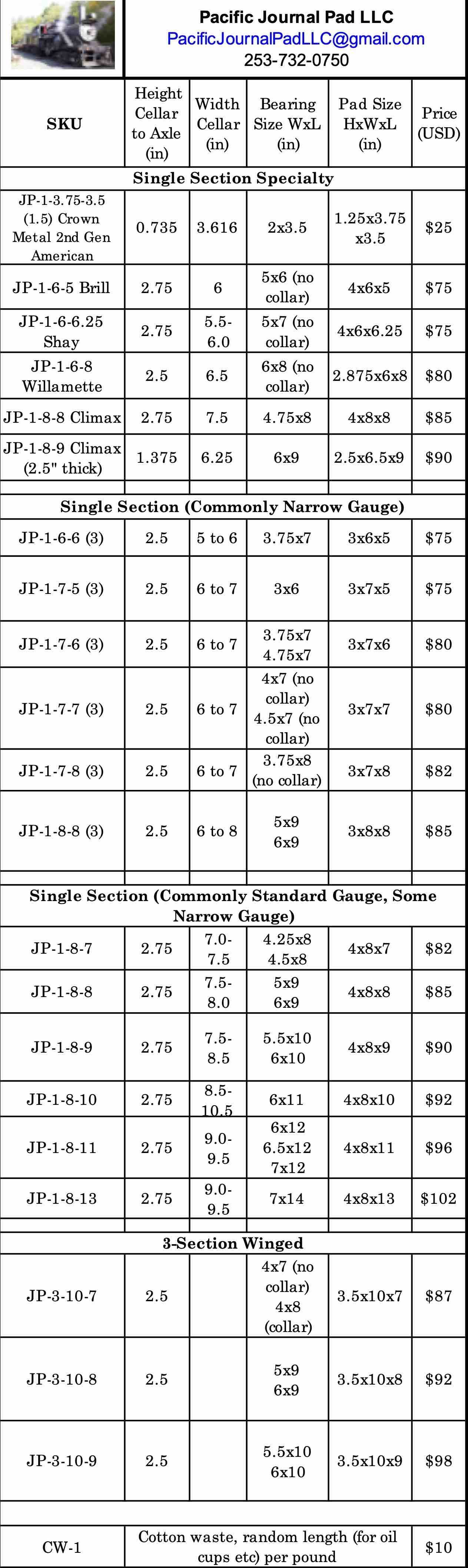

We want to build a database of pad sizes relative to axle bearing size so we rely on customers to bring their needs. Attached is our current 2021 price list for single section pads, with a few gaps where we need customer data on pad dimensions for those bearing sizes. We are happy to make any size or shape you need including winged pads.

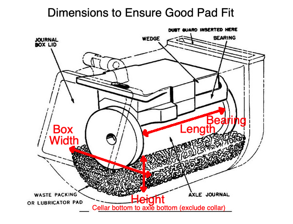

We've been busy making journal lubricating pads for dozens of railroads. Some orders included pads for geared steam locomotives, narrow gauge locomotive driving boxes, and several sizes of winged pads. We have learned that we need some key information to fit a pad correctly.
1. Vertical clearance between axle bottom and journal box bottom. Don't include the collar on the end, we just need clearance in the area that runs around on the bearing. This is usually about 2.75" for standard gauge rolling stock and 2.5" for narrow gauge, but it's best to check because it's important to have the correct thickness to avoid excess pressure or too little contact.
2. Bearing brass length along the axis of the axle. Actual lengths usually end in 3/4 and are rounded up to the nearest inch. For example 8 3/4" brass is known as a 9"
3. Journal box bottom width side to side as you look in through the door. This varies quite a bit and for smaller axles it's important to get a snug fit so the pad doesn't have excessie movement when the axle changes direction.

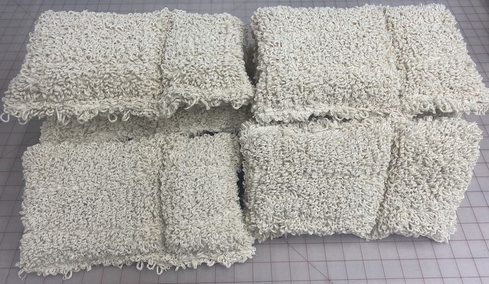

Recently, several theme parks required replacement pads for Crown Metal Products railcars, and were no longer available through their regular suppliers. They sent an example of the dimensions and I made up several batches. Now I'm on the preferred vendor list!

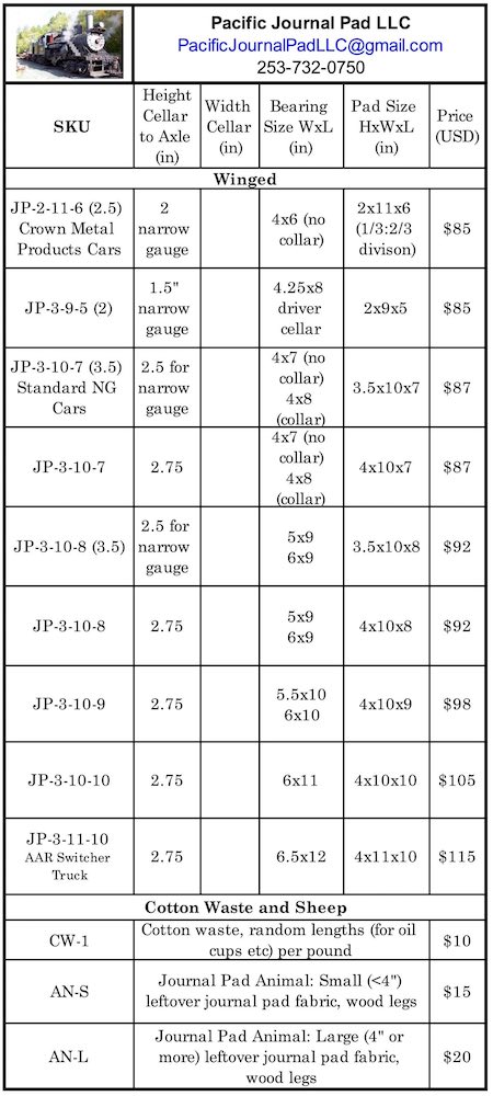

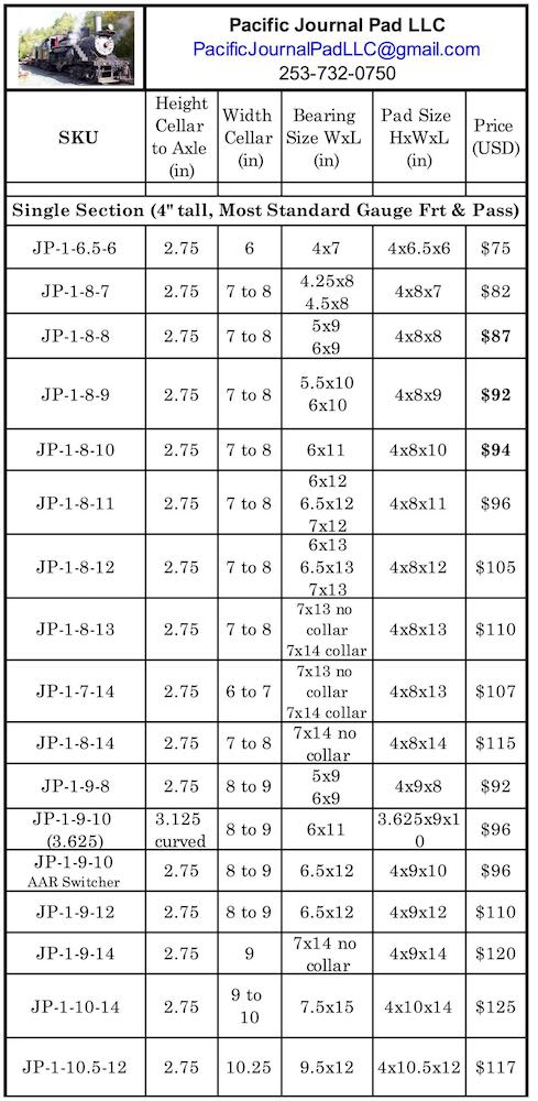

Shown below is a basic price list for simplicity, but the whole catalog became too long due to all the custom and one-off sizes. Since I make them all to order anyway, it's best to just contact me and let me know what you need. That way we can ensure it fits correctly since there are so many different box designs. Just send an email to PacificJournalPadLLC@gmail.com and we can chat via email or phone from there.
