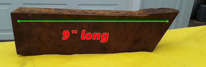

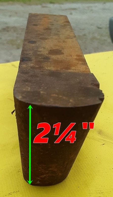

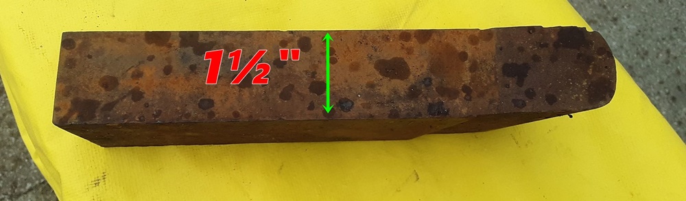

I may have some of what you're looking for. I've got 12 of these big cutting tools. Some left hand, some right and some straight.... I didn't pick them all up and go through them, but at a casual glance that's what it looked like. I don't know if they're just High Speed Steel, or some special steel like "Carboloy". There aren't carbide tips on any of them.
I saved them from going to scrap when the railroad shop here in town got rid of their big lathes (they hadn't had a wheel lathe in decades, but they had a big 36" swing lathe and a big boring mill there at the end. Machines went to razor blades, but I grabbed the tooling. I don't know for sure that they are for wheel profiling or not, but with the big radius they have, that's what I thought they were.
(Not sure why the pics turned out so big. I cropped them and reduced their size with a photo editing thing on my computer, but~. I hate seeing posts with pictures that do that!!!
I will probably forget to come back here and look at your response, so if you check back on here.. come over to the main page and say something... or try a private message.
