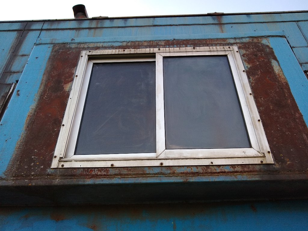

Joe,
I need to replace the glazing in all of mine too.
Are yours like this?
I am thinking of using laminated glass like a windshield if I can get the frames apart.
Bill

PostPosted: Sun May 10, 2020 9:02 am
Posts: 117
Location: walton, ky
My windows are that style. Your's look narrower. Mine were 28x22. Locomotive windows are 18 3/4 x28. You may be able to get away with just putting in loco windows.
I ended up going with 1/2 lexan. I was able to source both window replacements for $170.
Joe

PostPosted: Thu May 14, 2020 9:39 pm
Posts: 211
I used the laminated glass for just a little less. Nice to have clear windows in the bay. As long as nobody shoots at it we should be fine... Now for the rounded ones.
