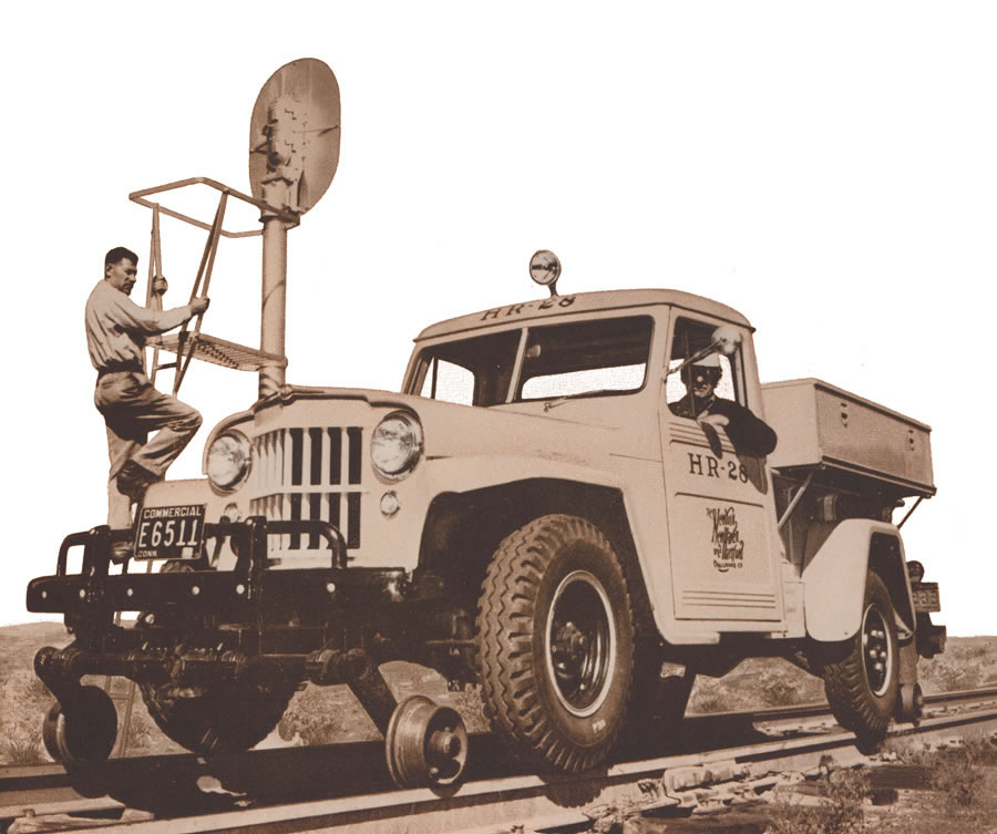

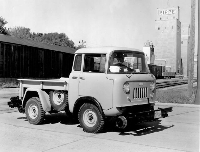

I am looking for information regarding the Fairmont Hy-Rail gear that is attached to the Jeep in the attached photo. What model it is, any compatibility similarities to more modern produced rail gear, and if any Fairmont rail gear can be found for the exact model of truck in this photo. It is for use in a restoration project of a authentic Fairmont Hy-Rail Jeep that has been long since stripped of it's rail gear. Any help would be greatly appreciated.

Have you tried contacting Harsco Rail, Fairmont's current owners, to see if they can help? They may, at least, still have drawings and other documentation.
http://www.harscorail.com/equipment/hy-rail.html
I'm not sure whether Jeeps needed the special rims to pull their tires into proper track gauge, but this is something you'll definitely want to check on your vehicle.
I spent an afternoon in the early 80s at Fairmont's (since closed) Toronto facility after picking up a number of motorcar parts. They had a number of new trucks in their shop at the time, being modified with hy-rail equipment. Apparently, at that time Dodge trucks could not be modified into Hy-railers because the tires would rub on the frames while turning.
Good luck with the Jeep- it'll be a great piece of equipment!

http://www.thefcconnection.com/fairmont_rail_cars.htm
I'd have no idea how to contact Dan Horenberger, who according to the link has acquired a set of hy-rail equipment to fit his FC-150, but he might be able to help with info, measurements, etc if you can find him.

The FC has Fairmont 0-307 gear on it. I have 2 manuals on it but are currently loaned out to the Southern MI Railroad Society in Clinton MI. I also have a brochure showing an FC with gear. The gear is now obsolete by Harsco but used gear is around, a decent set ranging from $500-2500. i have been restoring hy-rails since the early 70's. The hard part is making the brackets from the frame to the gear as Fairmont-Harsco isn't much help or has no interest in restorations. I've dealt with then since the early 70's. They might have a manual for 0307 gear for sale. Recently there was a set of gear on e-bay and also a couple of weeks ago a manual on the gear. Check Ozrk Mountain Rail Services on the net. They quite often have it for sale.

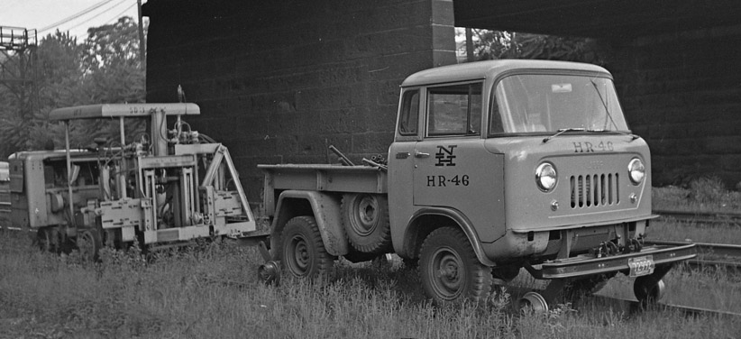

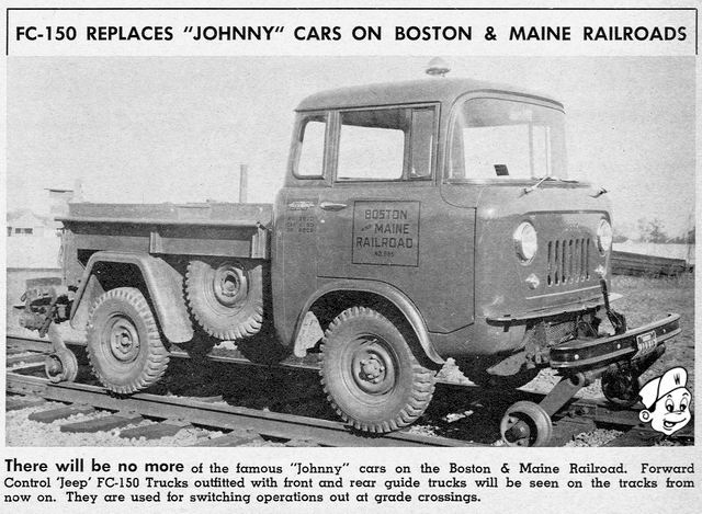

The New Haven had several Jeep hyrails. Here's a pic showing a Jeep FC in use in New Haven. I found the pic in when I was Supervisor of the Amtrak Signal Shop in New Haven. I also found another pic of a Jeep hyrail used by the Signal Department which I'll provide in a follow-up post. Both have early Fairmont 0307 hyrail gear which was upgraded later to the 0307A gear commonly seen today. I have 0307A gear on my '96 Bronco hyrail.

Here is an old Jeep marketing brochure pic of a New Haven Railroad Jeep hyrail used by the Signal department. Note the CT license plates.
