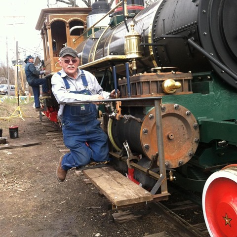

Posts: 490
Bruce Babcock and Leviathon. The indicator is barely seen. He rode on this platform and took cards.

I am preparing to take indicator cards on the J&L 58, the main reason being to help me determine the source of the offbeat exhaust and also as a training tool. I have a Crosby indicator, reducing motion and started work on brackets for a seat while I ride up front to take the cards. I had to drill and tap indicator ports in the cylinders as well.
There are many photos of doghouses built on the pilots of locomotives for the purpose of taking indicator cards and otherwise monitoring the performance of a locomotive. It was done from time to time but not often due to the difficulty and inherent danger involved.
