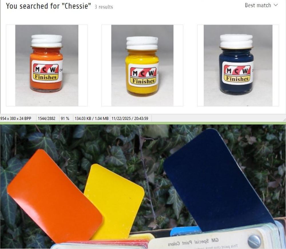

https://mcwfinishes.com/shop/ols/search ... d_by_match
This company custom mixed paint from paint swatches. Quite a few modelers have used to. Might be able to use it to get as close as possible as you can.

 Post subject: Re: Chessie Colors?
PostPosted: Sat Nov 22, 2025 9:57 pm
Posts: 1400
Location: Annville, PA
Oh boy, I don't think I can resist doing this... LOL

Matching to model paints is iffy for me. You don't know how they came up with the colors and a lot of them are off the mark especially when you look compare them in the sunlight.
