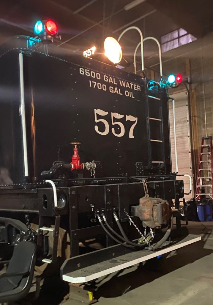

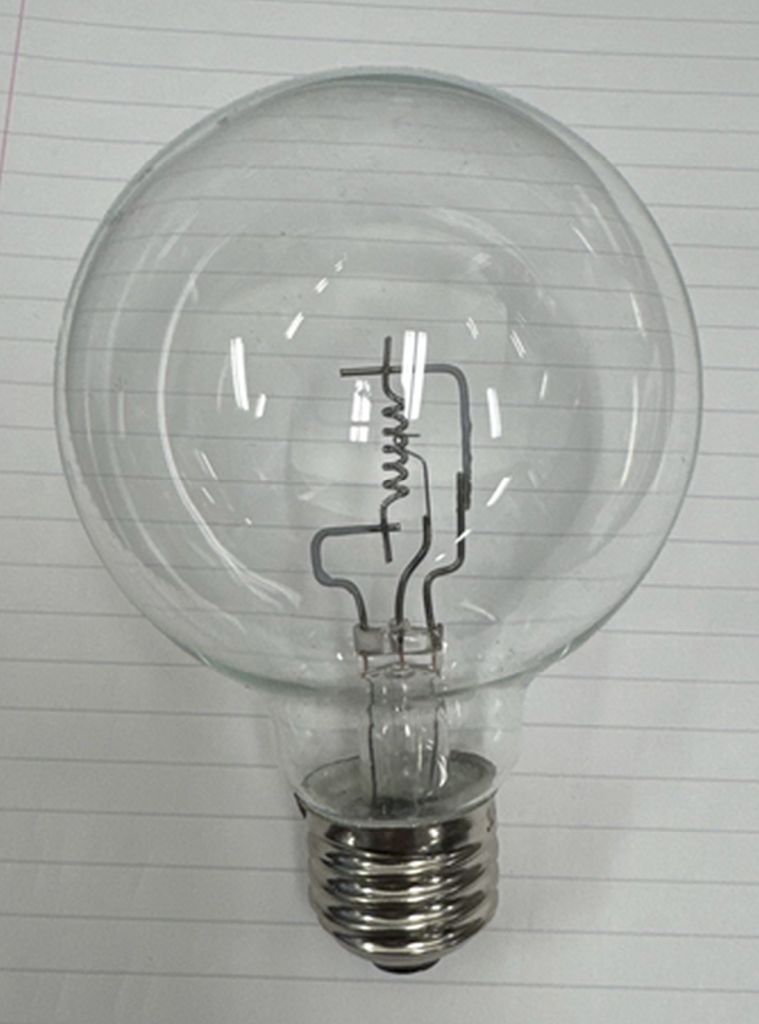

As a lifetime rail historian and the president, project manager, and chief visionary of the restoration of Alaska Railroad 557, Pat Durand has done everything in his power to make the restoration a success. With the locomotive nearing operation we only had 3 of the old Amsco 250 watt 32 volt incandescent headlight bulbs. They are no longer manufactured and a wide search found that there were no remaining stocks nor was there a suitable replacement.
Pat has arranged for a special production run with the Specialty division of Bulbtronics, Inc. for 250-Watt 32-volt bulbs for the PYLE National and other locomotive headlights with parabolic reflectors and has formed a company to procure a supply of these bulbs for Alaska Railroad 557 and to also make them available to the railroad preservation community. The photos show the prototype bulb and the bulb under test.
If you are a serious purchaser of at least 60 bulbs, ordering details are in the classified section. If you are not prepared to make a bulk purchase, please wait until retail suppliers to the hobby make them available in retail quantities.
Note that this a personal project by Pat for the good of Alaska Railroad 557 and the broader preservation movement and the Engine 557 Restoration Company is not formally involved in this enterprise.

Just a friendly reminder that the bulb and reflector work as a system. Before we start suggesting kluged alternatives (again), keep in mind that the position and emittance of the filament in relation to the parabolic reflector is what makes it work correctly as a headlight. Use a different light source, you need a different reflector.
