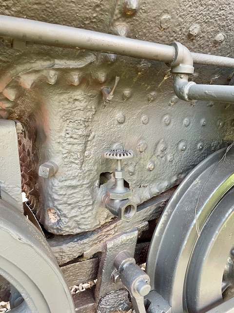

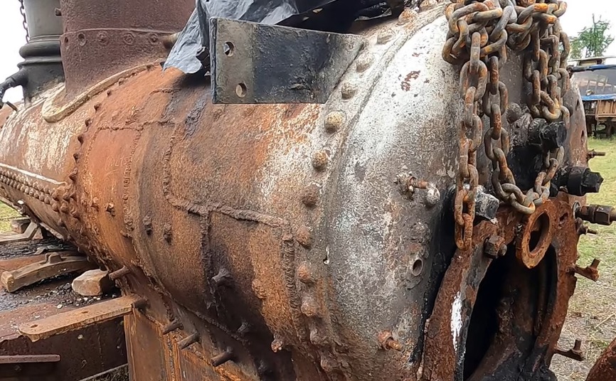

Hello All,
For those who find boiler repairs interesting, the following photographs might spark some questions . Answers might be a bit harder to provide..................your thoughts here, please?
Location is unknown..............
Take care,
Dave Griner

We stand behind our work.
Half a mile is sufficient.
All code welding, criminal code.

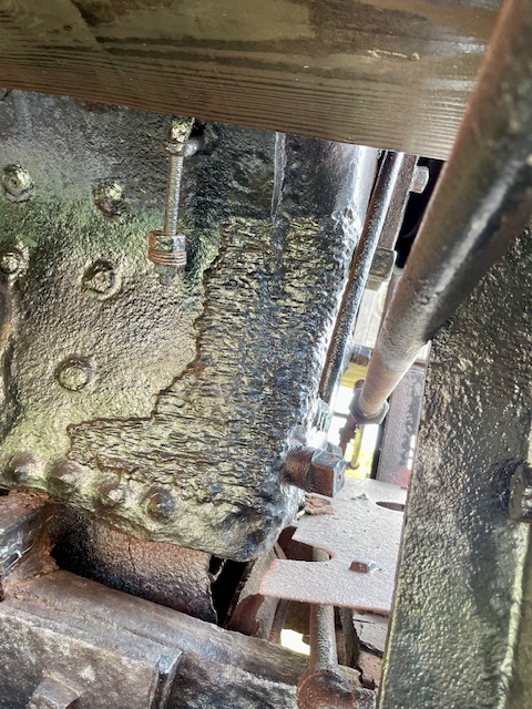

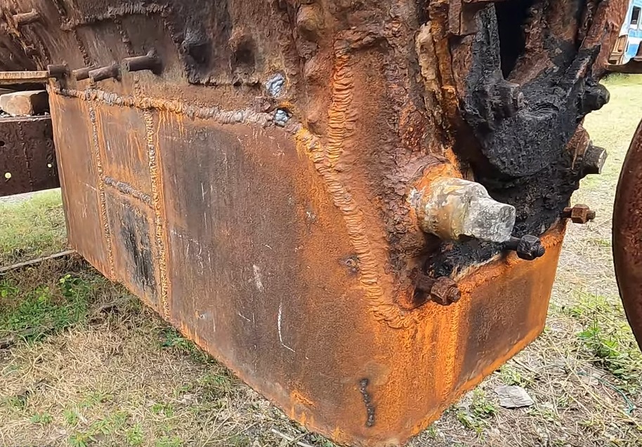

Reminds me a bit of repairs seen on one of the Quincy & Torch Lake RR locomotives from the Quincy Copper Mine in Michigan's Upper Peninsula. Clearly the sheets were already thin when the locomotive was retired in the 1940s judging by the post-operation wasting that's occurred. Granted, sitting outdoors exposed to the Northern Michigan climate for the last five decades or so probably hasn't helped things.

It has been 40 plus years since I took a good look at those engines outside near Hancock, Mi. Always felt that the boilers on those locomotives were fascinating to view as far as old repairs went. It lent a new meaning to "patch work". To be fair there was a newly built boiler in the engine house many years ago not sure what locomotive it was meant for. Think it sat on the floor but not sure anymore? Fascinating history. I toured the place Christmas Eve maybe 1975-ish or so. Went into the basement of the machine shop that was fully intact minus part of the roof. Totally unprepared to document the place with no camera or flashlights. It was getting dark out and snowing so we went to a bar downtown.
Back to the boilers outside. Working nearby to ready the Copper Range #29 for its trip to Mid Continent {2004 at Smelter plant}. I was not able to view the Quincy and Torch lake engines as we were working under a time constraint waiting for crane and trucks to show up. It was kind of sad to look at the condition of those little engines and the repairs made to them. But it was the most fascinating thing to really look at. Both the boiler repairs and the entirety of it all. It was a display ready to display on what could be done in the back country away from class 1 railroads. IF you were to restore any of the three there would be absolutely nothing left of the original locomotive. The fourth engine ended up at Huckleberry in lower MI. I think that was repatriated back to Hancock area but lost track of it and what if anything is happening up there. It is about a 4 hr or more to get up there and another 4 hr back, so I don't get up there often. Any news what is going on up there more recently?

Holy mackerel Dave! I believe those photos deserve prominent display in your collection of boiler artifacts and oddities.
I assume all those radial and unsupported welds were x-ray certified, no worries.

The picture posted is just one corner of one locomotive, fireboxes, barrels, smoke boxes, all were a fascinating array of bad repairs. But apparently they worked! I have pictures but are unfortunately not digital so it wouldn't do me any good to find them. Funny how somethings just hit you and those repairs got to me. But in all fairness I saw both repairs and welding to many locomotives from class ones that were pretty ugly too. Quincy and Torch Lake did not have a monopoly on questionable repairs and welding. Many logging roads were equally bad. I am glad nobody tries to fire one of these up to see it run in the present condition. But I also think all the Q&TL
engines are super cool. I also like your comparison of the Q&TL to the now restoration in progress at East Broad Top. The UP of MI is a treasure of history and artifacts.

It appears from the first photo in Mr. Griner's post that they started replacement of the firebox below the firedoor, but never got past welding in the lower sections of the wrapper sheet and maybe the side sheets, but Yikes!
