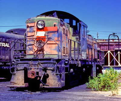

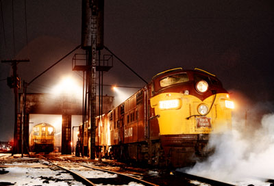

With some discussion of Alco RS-1 locomotives on RYPN recently, I will just mention that I recently came across some notes showing a price of $112,000.00 in 1952. For information or amusement as you see fit. If you have better info, please share, original price info is hard to find.
PC
