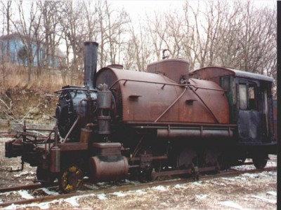

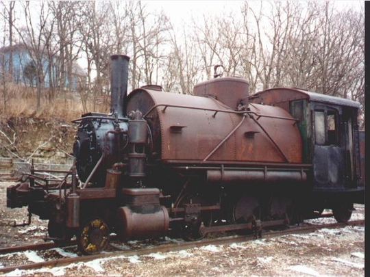

Hello Looking for any information on this locomotive if available. I cant seem to find very much on it. Was in contact with the Alco Archives and they don't have any information on it at all
Its an Alco Cooke Works
Built 10/1922
construction number 63534
Built for the Boyne City lumber Company
2-6-2T wheel arrangement

Since this photo is the same as on Steam Locomotive dot info, I presume you clicked on the notes and ownership links?
https://www.steamlocomotive.info/vlocomotive.cfm?Display=1743

Until I saw this particular photo, I hadn't realized that the distinctive sand dome that the Cooke Works used on their "stock" 0-4-0T's, had also been used on a 2-6-2T. Always something new to learn about steam!

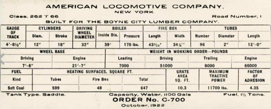

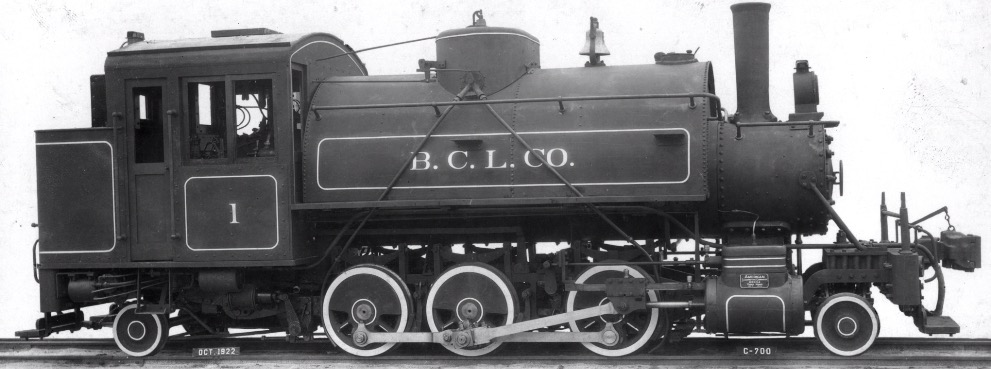

Here is the builder photo and info...
...you are welcome.

Hi Ben, i forgot before. Here is the link to the builder photo in HD 4000x1457 pixel.
With that you can cee many details and read the builder plate.
https://www.digitalarchives.wa.gov/do/D ... F47D7C.jpg
...you are welcome.
The tractive effort is shown by ALCO as 11700 which seems low to me. I would expect a standard gauge Prairie, especially one with a saddle tank for extra weight to have more T.E. What am I missing?
 Post subject: Re: Alco Cooke Boyne City Lumber Company
PostPosted: Sun Mar 27, 2022 1:02 am
Posts: 268
Hi Les,
you missing the size! This is a very tiny double ender, only 66k mass with 51k on drivers.
Only 12x18 cylinder, 32" drivers -> in Baldwin classification this is tiny a 10-18-1/4D. The
most 2-6-2T we know are 16/17/18x24 with 44" drivers and double that weight.
If you have a big garage this loco could fit...
PS
The cylinder size is the same as Dan Markoff's "Eureka" 8-18C.
