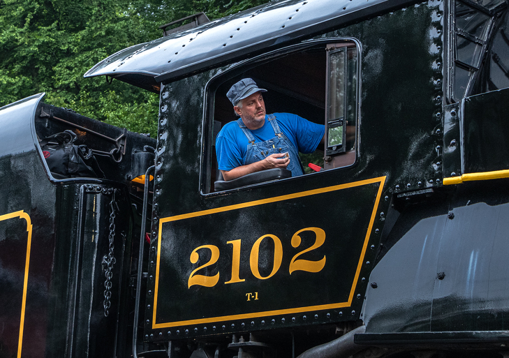

...and the Reading yellow, Hostler, is the same color as Lackawanna Yellow which I'm thinking you might be familiar with. Mr. Mueller is currently using an Imitation Gold-like yellow ochre on #2102. You can tell it's just a little too dark to be Reading Yellow but hey, a gallon or two of New Caterpillar Yellow isn't hard to find right off the shelf... ;)

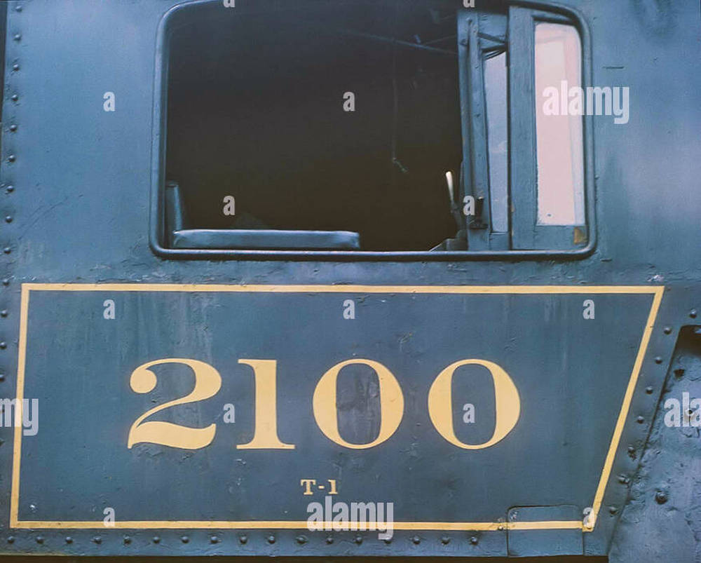

Regarding the cab window frames, all the postwar color pictures of Reading steamers that I've managed to collect so far indicate they were painted black, at least the exterior portion.
According to Mr. Hall in his book, as of 1923, the Reading did use the station brown and buff combination as interior colors in their standard cabooses. Whether or not this may apply to the steam locomotive cab interiors as well, I don't know, but if you happen to discover another finish color besides black on the window frames, Hostler, chances are fairly good it would be the station brown.
That's what color Andy's window frame appears to be and I'm still looking at Johnny's picture. LOL The Duco lacquer can and will wrinkle up and crack like that, however.

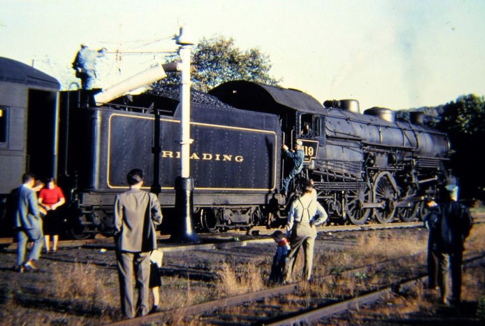

No longer clad in shining armor because it never was, here's #119 up in Pine Grove with its black arched window frames...

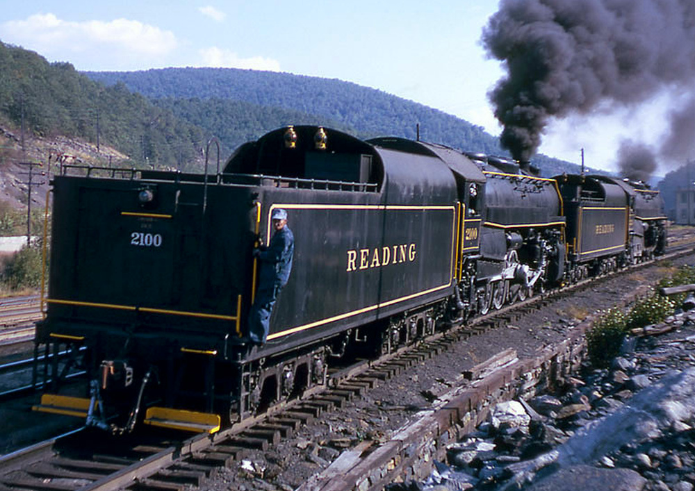

The Reading definitely got some Dulux 028 Caboose Red from DuPont, Phil. We have a receipt for that.
As far as the window frames go, I don't think there's any doubt they should be black as in this shot from September of 1964...

Now this is a view you don't see too often. Apparently, with the special ramble scheme, the locomotive number on the rear of the tender was painted in Aluminum as well as the train steam connection down by the coupler...

119 was not a streamlined Crusader engine; they were 117 and 118. 119 did get a new set of drivers; still spoked but better balanced. The rebuilt G-2-s-a engines retained their as-built drivers but the new G-3 engines got cross counterbalanced main drivers.
I believe the cab interiors were institutional green. But that goes back over 50 years.

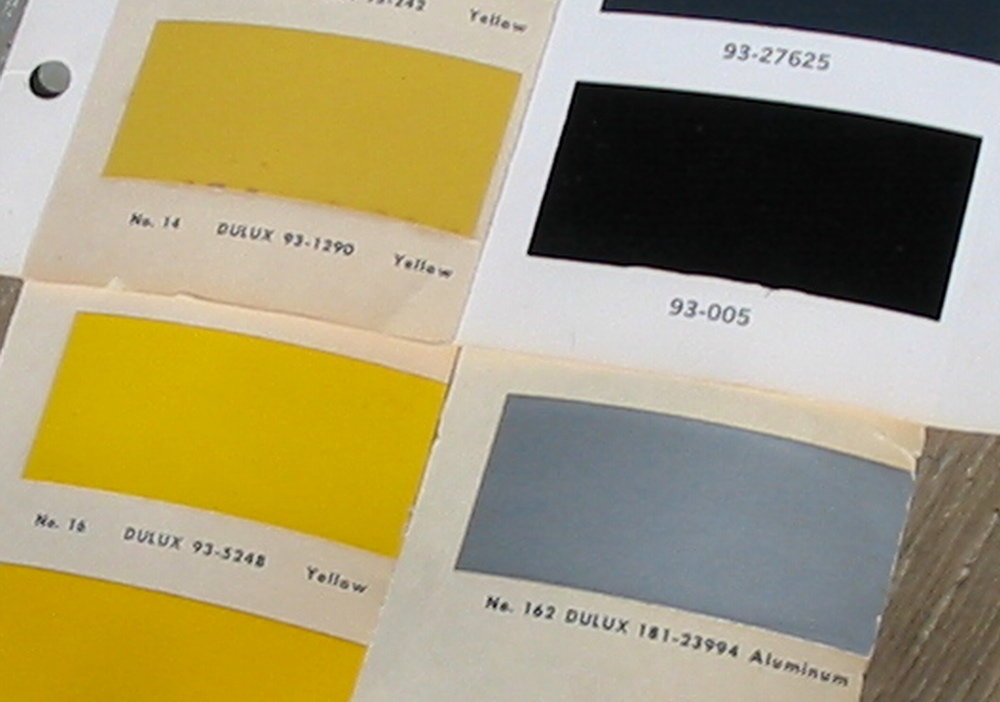

I know the NYC used DuPont 6202 Green as a steam locomotive cab interior color, the same color as Libman mop and broom handles. According to the caboose book, the Reading's International wide-vision cars were that pale green institutional color inside and also the second-generation EMD cabs. The first-generation diesels' cab interior color was typically Suede Gray like the F-units and GP-7's.
Here are all four colors together, as I have them so far, in their DuPont Dulux automotive fleet color versions, Hostler. 1290 GMC Venetian Yellow and 005 Black are the standard colors while "Safety Always" 5248 Lemon Yellow and 23994 Aluminum were added for the rambles. 54701 Fruehauf Yellow, partially seen in the lower left, is the Penn Central's safety yellow and also used by the Alaska RR. I had wanted to get the 014 Imitation Gold chip into the picture as well but that didn't quite work out. LOL
BTW, welcome to the site!!!...

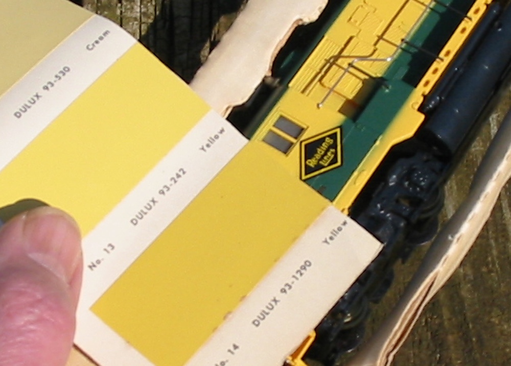

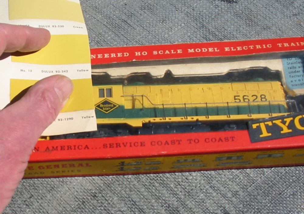

The yellow on the original early-sixties Tyco Reading GP-20 is also a close match to DuPont 1290 so it's pretty much the same color on the GP-30's, 35's, etc., only lots more of it. The model does look slightly more orange than I think it should but it is molded in a somewhat translucent plastic, not paint. The next time I head down there, I'm taking that thing with me just to see because I forgot to do it the last time around...

What the heck, why not? LOL
That's the standard Reading Yellow on the caboose body and safety yellow on the handrails and brake wheel. On the SW-1001 in its "green machine" colors, it's all safety yellow and along with black on the pilot.
The colors on that Tyco model might be fairly accurate, huh?...

Figured I'd try that again this morning in an attempt to cut down on the amount of red emanating from the body shell. Looks like I've achieved a moderate level of success this time around so that's always good...
