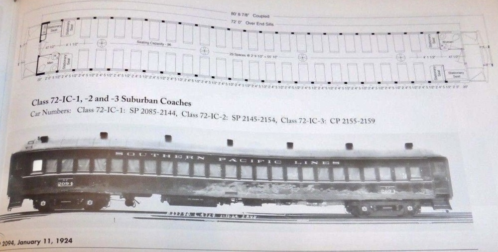

Posts: 268
See the only picture i have.
:-) Uwe
PS @Dennis
quote
"Most Southern Pacific passenger car drawings from that era are privately held by an
ex-employee that saved them and are not presently available."
Source?
"heard" "may" "someday" "would be"
sound very convincing

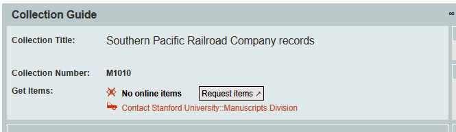

The Stanford University library Special Collections has a collection of SP documents of various types that it was given by the Union Pacific after it acquired the SP.
Some years ago after Orange Empire (now Southern California) Railway Museum acquired one of the commute cars, I found that the Special Collections had folders with the specifications for these cars. I was going up to the library and the Special Collections for some other research and requested that folder. I had a copy made of the specs that I then passed on to OERM. There were no plans in the folder.
I looked at Stanford Library webpages; and access to its database seems hidden. https://library.stanford.edu/libraries/special-collections
But using Online Archive of California a state-wide joint data base, I found this information:
The 1920s cars are the 72-IC-2, -2 and -3 classes. 72 foot long, Interurban Coach, sub groups
