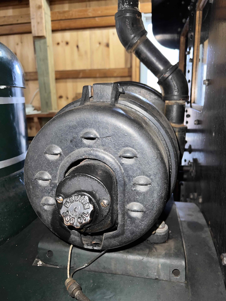

Good evening,

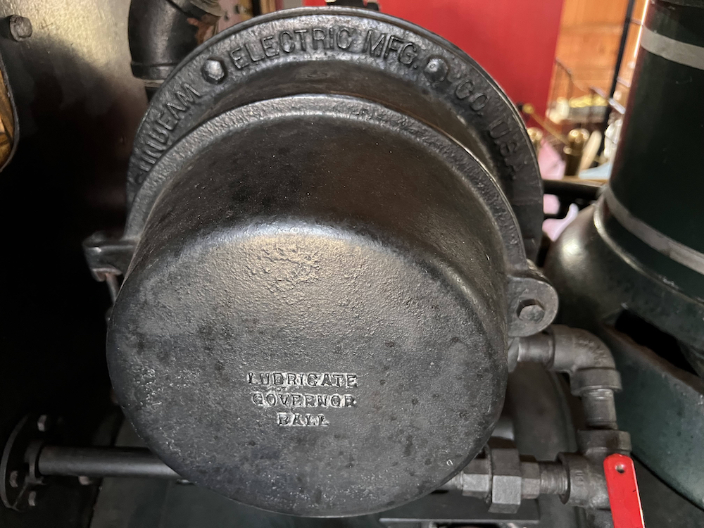

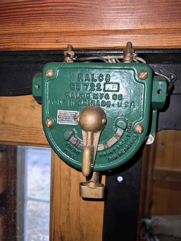

I am doing some maintenance work on a 1925 Baldwin steam locomotive, and as part of winter maintenance am completing a complete rewiring of the electrical system. The previous wiring job I am finding is both incomplete and questionable, and I am having trouble finding light bulbs, resistors, and information on the electrical system.
The locomotive is equipped with a Sunbeam Turbogenerator, as well as two Sunbeam Headlights. I am unsure of the model, as the tag is missing, but I believe it is a 32v 500w turbogenerator.

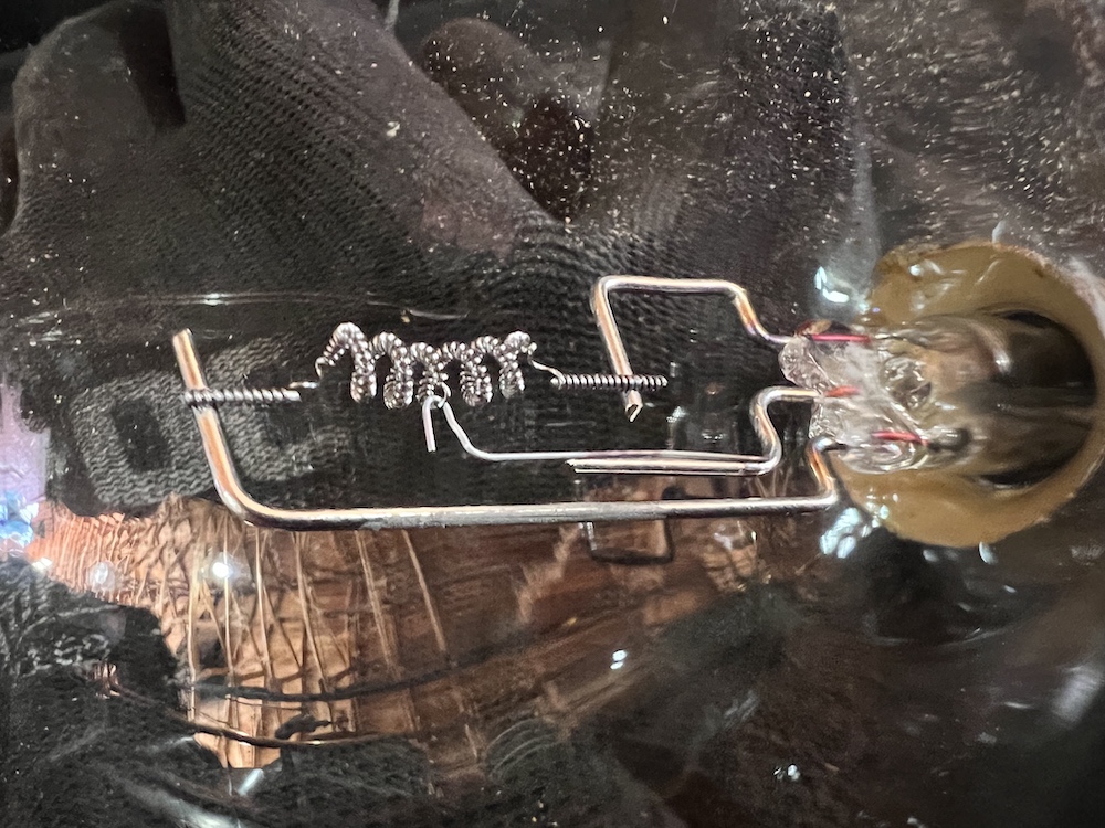

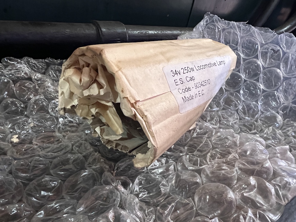

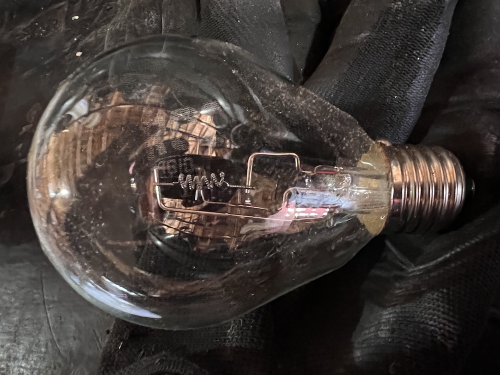

The light bulb currently in the headlight is a 34v 250w bulb labeled "Made in EC". The locomotive is missing the resistor and fuse box, as the wiring was only partially completed, so currently will only operate on high. The switch is a Ralco three position switch, with a bottom twist switch for the cab light.

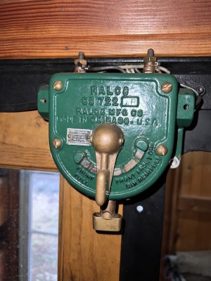

File comment: Ralco Switch
File comment: Sunbeam Turbogenerator Fireman Side
File comment: Sunbeam Turbogenerator Engineer Side
File comment: Light Bulb
File comment: Light Bulb Package
File comment: Light Bulb Closeup

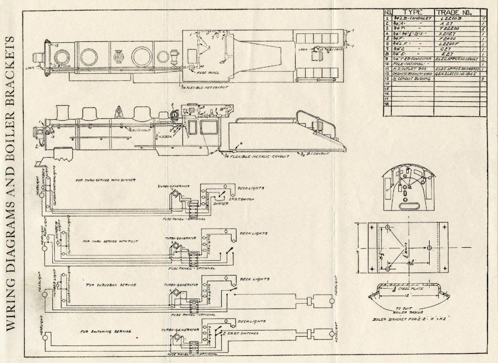

 Post subject: Re: Steam Locomotive Headlight Bulbs, Resistors, and Electri
PostPosted: Mon Feb 20, 2023 6:17 am
Posts: 543
Location: NE PA
see file for dimming resistor info and wiring diagram
rfExtractPage1.pdf [33.49 KiB]
Downloaded 469 times
rfExtractPage2.pdf [11.81 KiB]
Downloaded 422 times

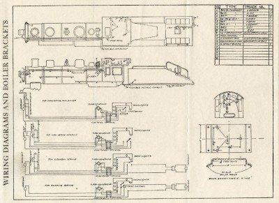

Those images have been compressed quite heavily. While useful information, including resistance values, may be read in the second image, the wiring diagram image conveys little usable information. A higher-quality, less-compressed set of images would be helpful.
PostPosted: Mon Feb 20, 2023 10:51 am
Posts: 543
Location: NE PA
Bob, Thanks for the heads up on the poor quality of the PDFs. I was unable to edit the original post for some reason. I have posted better quality images below (I hope!).
Resistor info
ExtractPage2.pdf [862.68 KiB]
Downloaded 448 times
Wiring diagram

If I understand correctly, that bulb won't need a resistor for 'dimming' in the typical voltage-reduction sense. There should be three contacts in the socket, two corresponding to the 'regular' and 'dim' positions, and one for common return (as in a domestic three-way switch). Examine the switch: it will either have two positions supplying 32V or two positions to a common ground.
See how the center conductor is a 'center tap' for the filament? High will energize the length of the filament, dim will energize half of it (probably with the other half taking up some glow by conduction) AT THE SAME VOLTAGE... and the current should look after itself.
I'd naively expect the center-tapped wattage to be around 125W, 32V, P = EI, P = I^R to get the tapped-filament resistance if you need it. I doubt you need a ballast or power resistor in that circuit unless you need overspeed control should the filament suddenly fail under load...
Typical 'three'way' bulbs have two distinct filaments, one from each contact, and the switch goes 1, 2, 1+@ in rotation to connect them. The pictured design probably stresses the center of the filament, especially in jolting or vibration, and I expect that if the filament fails it will 'fall off' the intermediate contact rather than keeping a 'low' reserve -- this leads me to wonder whether screwing the bulb in to leave the 'hook' in the contact facing up gives you the best chance of keeping low if you have a break.

Last I knew, as of several months ago, AAMSCO had stopped production of the 250 W locomotive headlight bulb and has no plans to resume making them. We have not been able to find another supplier so far. Diesel locomotive PAR sealed beam lamps in the correct voltage and wattage are available but they require modification to the headlight case and don't look right.

If you just need it to work, put a modern diesel locomotive 32V 250W sealed beam bulb in it... Easier to get and will probably give you better light....
This is for use on an operating steam locomotive. Use in the dark is currently limited, but we are preparing for expanded operations which may include more nighttime operations. At the moment is more for visual appearance and having a white light on the leading end.

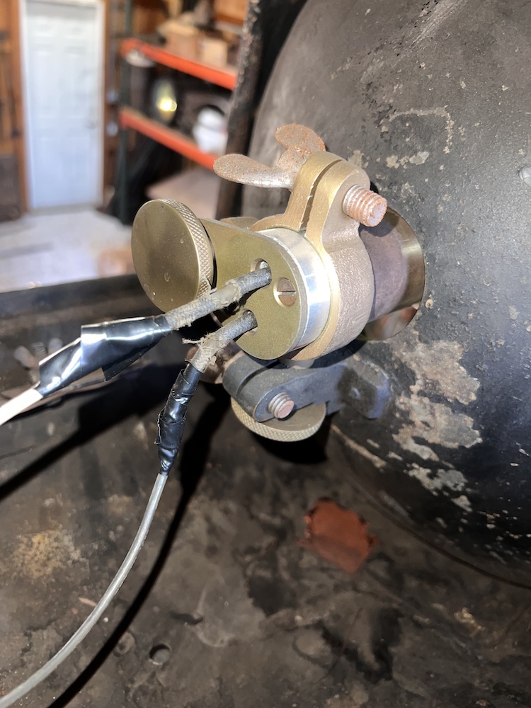

I did notice what you pointed out above and was curious as to if that was a possible function. The only thing there I do not see is where a third wire would attach to the outlet? I will have a chance this weekend to look at the outlet better but from the picture attached I do not see anywhere the third wire would go.
If the above is the case, are the two inputs able to utilize the one common return without back feeding the input not in use?
The idea of leaving the "hook" facing up is an interesting thought, and emphasizes the need to find a source for replacement bulbs.

Does that bulb actually have two contacts on the bottom?
I don't think it does. A threaded base isn't conducive to contacts on a bulb aligning with contacts in the socket. It's not feasible. A bayonet mount (like older brake/tail light bulbs).. I could see that, but not threaded E26's.
I suggest that the center post inside the bulb is to steady the filament, since it's a rough service bulb. Don't want that filament to break during use while white hot. Look in the glass envelope the filament leaders are anchored in... you can just about see the two outside leads going down to the base.. .there's nothing beneath the center post.
Surely the headlight switch contains the resistance for dimming.

Is this the same socket and bulb base as on a 3-way household lamp? The come in both standard and larger Mogul sizes.
