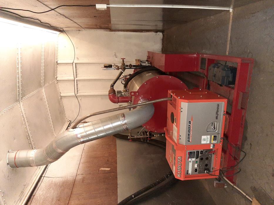

Wilmington & Western converted a boxcar to a heater car using a commercial skid mounted steam generator from Sioux Corporation.
https://sioux.com/steam-generators
- Alan Maples

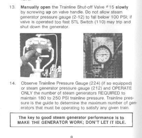

We keep the rear open to keep steam moving. All cars have working steam traps.
I know the bundles in the car only carry a few pounds of pressure. We normally operate all on, then all off. Conductors call for more less heat.
Our Steam Generator manual clearly states keep train line steam pressure at 180 - 200 PSI
Everything seems to work like this...
We just want to start modernizing some equipment.
Does anyone have manuals or instructions for operating the train side of the heating system?

That manual must be wrong, or a typo. I can't imagine sending full boiler pressure down our trainline. It would be a safety hazard. I have participated in annual car inspection, and I would not trust our pipes to hold. The style of hose connections we use between cars are pretty delicate, as well.

The Everett Railroad runs a seven car train with 60 PSI of steam trainline pressure. The hoses between the cars are modern and steam rated.
I had a copy of a PRR Passenger Car Heating book, which of course I can't find now. As I recall it specified 10 PSI per car in temperatures below freezing. If a passenger train were 20 cars long, pressures might be pretty high.
I do have a copy of an IC Passenger Car Heating Rules book dated 1926 which specifies 10 PSI of steam trainline pressure per car in temperatures above 20 degrees, and 12 PSI per car when temperatures are below 20 degrees. On trains equipped with all rubber steam hose, steam trainline pressure may not exceed 130 PSI. On trains where the loco and first four cars are equipped with "metallic steam conduits" pressures of up to 170 PSI are allowed.
