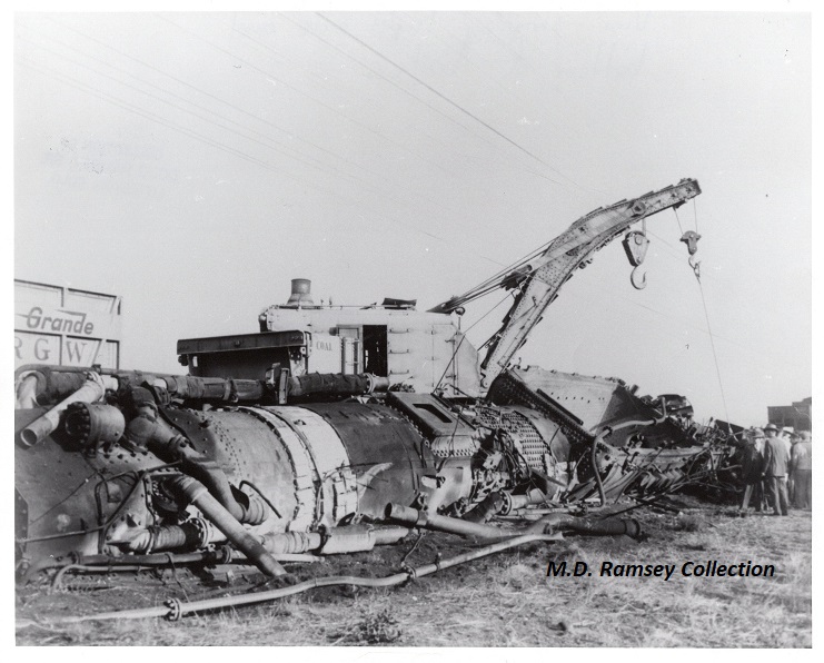

I have a copy of the DRGW Superintendents Telegraphic Report of the incident that is dated November 11, 1952. The mechanical description as outlined in the ICC report are the same in the DRGW report. While the ICC report concludes that the explosion was probably caused by low water, they provide no other conclusions or possible contributing factors. They just stick with the facts regarding the mechanical condition of the locomotive and the general condition of the crew.

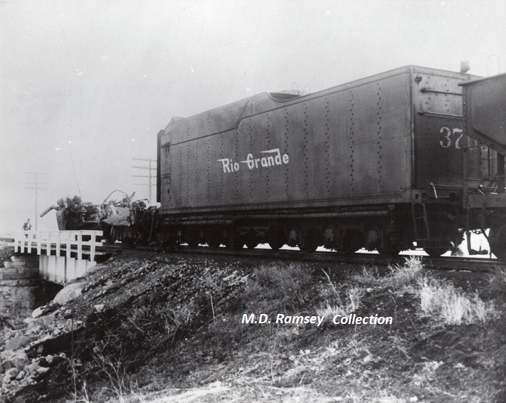

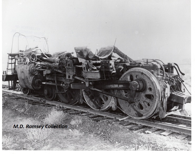

In addition to the DRGW Report, I also have several photographs in my collection of the aftermath of the 3703 explosion. I was always amazed at how the force of the explosion broke the massive hinge casting between the No. 1 and No. 2 engine, sending the No. 1 engine rolling down the track until it stopped 2, 380 ft. south of the point of the explosion. See the second photo.
