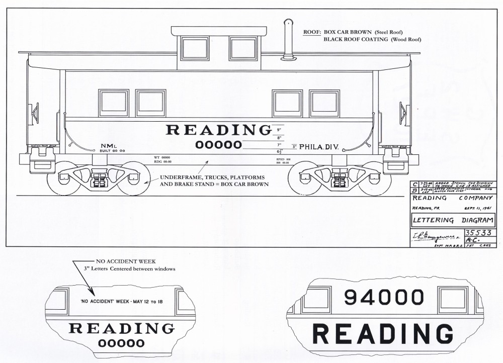

Can anyone direct me on where to find a paint and lettering diagram for Reading NMl cabooses, original red scheme? Online search turns up zilch.
 Post subject: Re: Reading Caboose Paint & Lettering Diagram
PostPosted: Thu Oct 31, 2024 9:05 am
Posts: 1400
Location: Annville, PA
It's on Page 170 of the caboose book, Eric. I thought the trucks, underframe, end platforms, and such were the darker structure brown but apparently they were the same freight car color as the roof. This is the original NMl lettering layout with the smaller road numbers which were increased in height by two inches later on...

Many thanks for the image. I'm guessing the next chore is to draw the lettering. I'm usually stuck scaling from photos unless anyone happens to have the appropriate Rwading lettering set drawings (hint, hint).

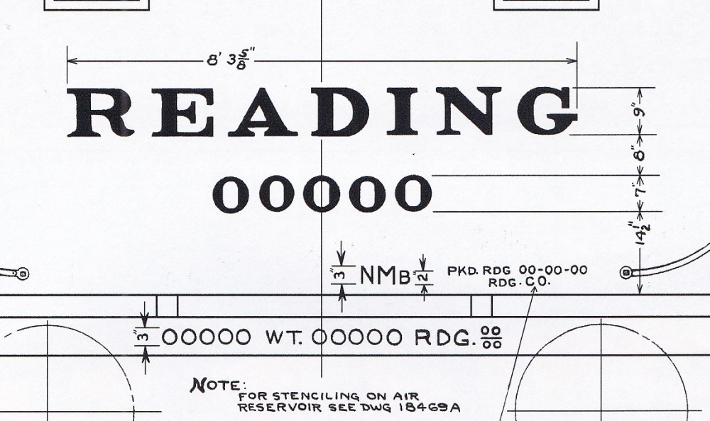

Something looks a little off on that drawing, Eric, so here's a closer look at the diagram for the bobbers...

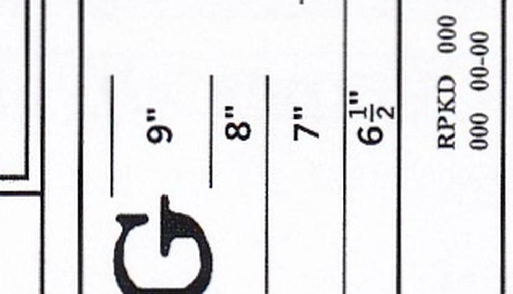

On the NMl drawing, I'm getting 9", 5", 7", and 5" instead...

Yeah, I thought for sure that 8" might be suspect. I'll get a tape measure on the car side to be sure. Everything has to squeeze under the belt rail so it'll be lower than what's on the bobbers. At this time, I'm going to assume that the width of "READING" is the same as on the bobbers but I'll check by scaling photos.
Seems to me the car number is above end doors. Are those 1" tall? They look pretty tiny.
