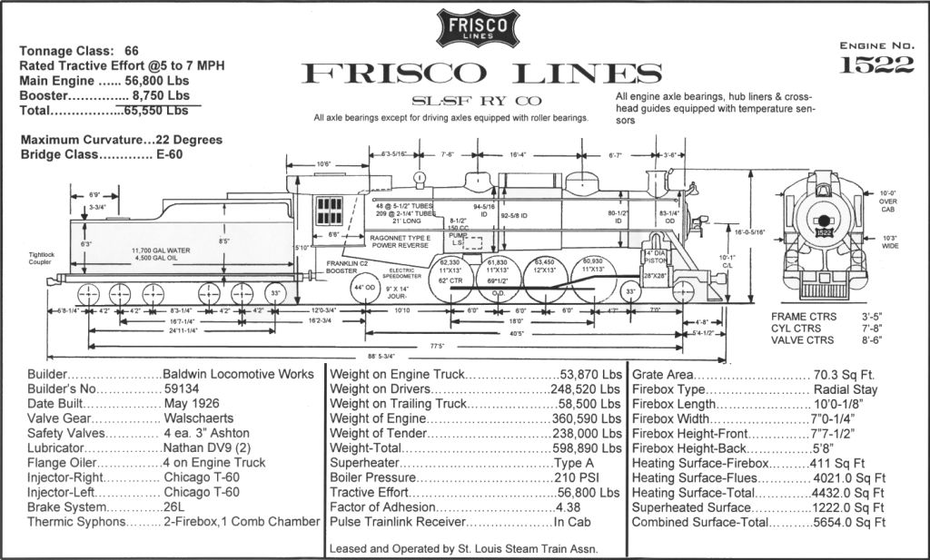

Posts: 1325
Location: Pacific, MO
3'9" is the correct answer according to the erection card I have but RYPN won't let me share for some reason. The 3/8" is OK either way. Flues/tubes 21'0" long.
 Post subject: Re: Frisco Steam Question
PostPosted: Fri Oct 11, 2024 5:54 pm
Posts: 1325
OK, this diagram doesn't give combustion chamber size,
Looking at the erection card, it is 3'-9 long.
