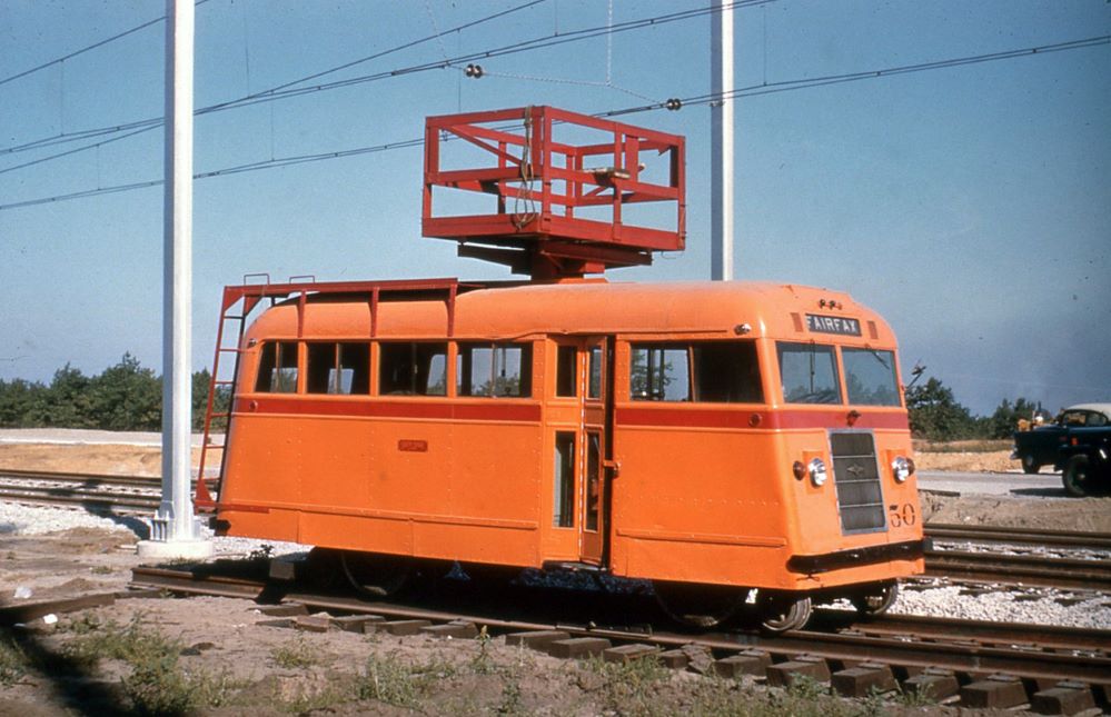

Here is the line car.

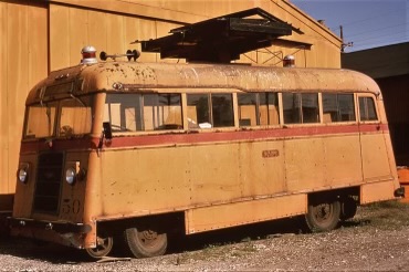

This is apparently an Al Chione photo, note "Fairfax": https://transphoto.org/photo/1063563/

From the first photo, the car still has its platform and a roof beacon has been added. Can I assume the car lasted into tie late 1970s or early 1980s since it has the beacon?

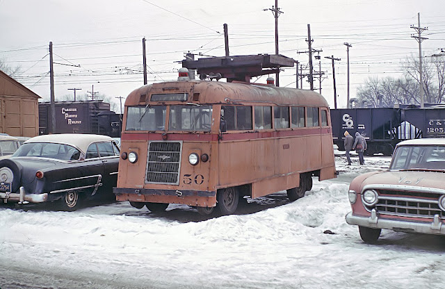

There isn't a lot there, but starting on line 2210 a car 50 is listed as line car-gasoline driven, car builder Evans Auto-railer, built 1937, ex-Arlington & Fairfax Ry.: https://southshorelinemuseum.org/wp-con ... edger.xlsx
and https://towns-and-nature.blogspot.com/2 ... shops.html
"Marty Bernard posted
At CSS&SB Shops, Michigan City, IN, 12/26/1963
A "line bus" as opposed to a line car. Probably once used to fix the wire above street running and it could easily get out of the way of trains. But it had high-rail wheels too. Looks by the snow around it, it had not been used for awhile. My guess is that is Roger Puta and Rick Burn in the distance.
Bob Harbison: Look closer... Highrail gear, not just street running. It went anywhere it needed to go.
Bob Harris: This was an Arlington & Fairfax railbus. The South Shore Line bought it for the construction of the East Chicago Bypass. The South Shore Line equipment ledger shows that it was built by Evans in 1937. There is no retirement date from the South Shore Line listed in the ledger for this piece of equipment.
Marty Bernard shared
Mitch Markovitz: The "Fairfax." Purchased to do line work on the East Chicago relocation."
280466873_2922916041333647_5136655461150142957_n.jpg [ 92.87 KiB | Viewed 10155 times ]
