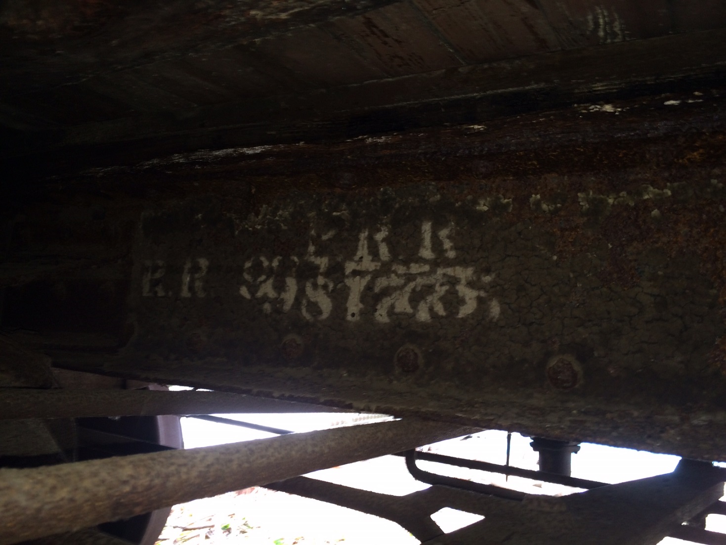

We found a number stenciled on the center sill. It appears to be 998177. It's hard to tell for sure, because the stencil seems to have slipped during painting, and there's a kind of double image that partly overlaps in a vertical direction. The brake cylinder is stenciled 7-26-65. The brasses are still in the journals and they're still oiled. The car is on a short length of track. The roof is completely gone. The smoke jack is inside, but the stove is missing. A conductors desk is still in there, and a coal bin.

The number of the car is open to debate I suspect. I have attached a photo of the numbers and after staring at it on the laptop, I come up with 981775 which is more in keeping with the N6b number series. Kind of a combo of google searching for N6b cab numbers and comparing that to what we found on the car.

It really looks like 981775 to me, painted twice with two different fonts, but I don't know if that fits the PRR numbering scheme.

The number 981775 would be correct for an N6b.
I checked the 1957 roster of PRR cabin cars on the Keystone Crossings website, hoping to find information indicating that the car was in use in the New Jersey area at that time. Unfortunately, data for other years is not available on the site, and the number seems to have been vacated on the roster by 1957, indicating that she's probably been at her current location for a very long time, probably over 60 years. That's assuming the number 981775 is correct, which seems likely.

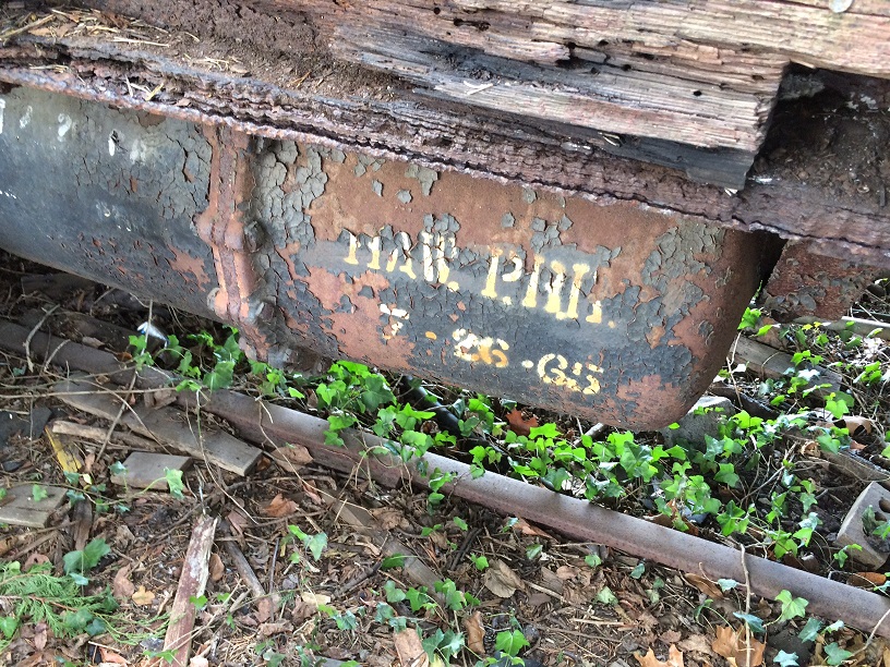

The last time the PRR did brake work on the car was 1965 per the stencil on the air tank. See attached. So, this thing was a survivor for sure.
What is "HAW." though?

In that case, I can't account for the car's absence from the 1957 list, but I really don't know how accurate that list might be. Another mystery.

Isn't there a Hawthorne Yard, Chicago?? HAW might be where the brake work was done.

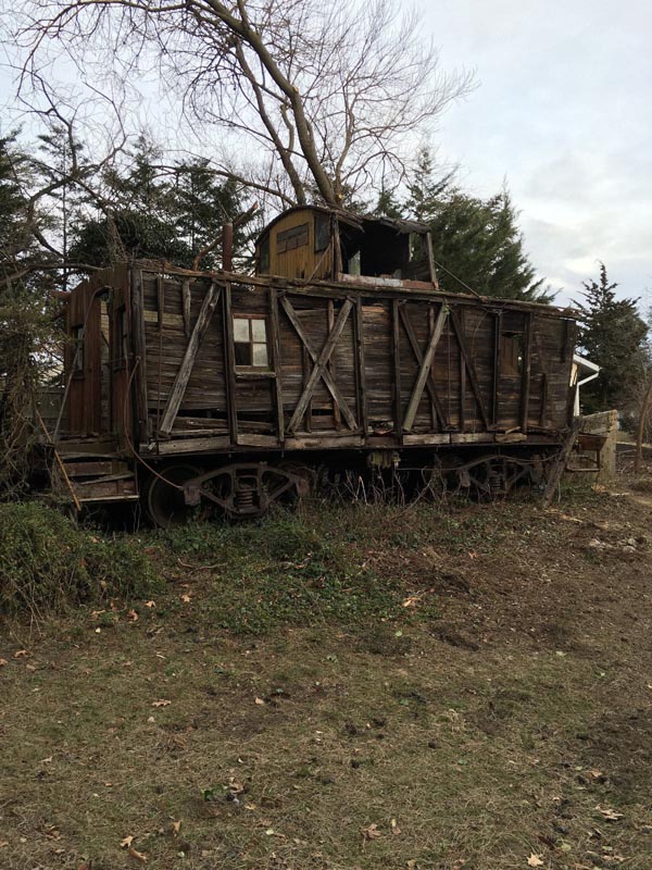

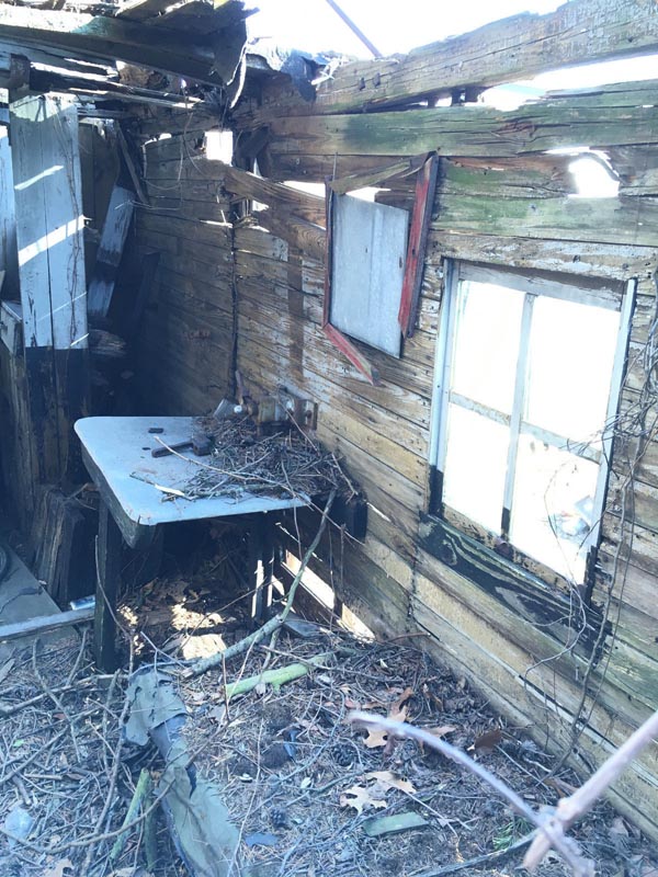

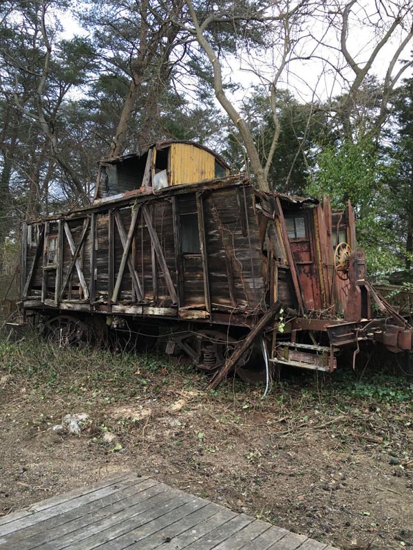

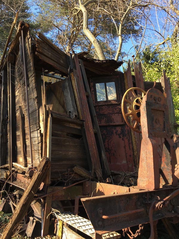

I'm saving and reposting a few photos of this only because 1) the eBay listing is likely to disappear any day now, and 2) IF this proposed rescue and reconstruction actually comes to pass, it will likely be the most spectacular set of "before and after" photos since the Rogers K class 2-4-2 K88 was dragged from a river in New Zealand and restored to operation.......
