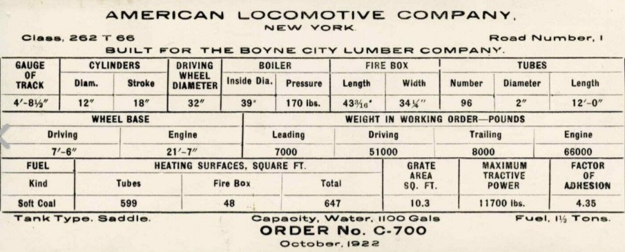

Here is the builder photo and info...
...you are welcome.

Hi Ben, i forgot before. Here is the link to the builder photo in HD 4000x1457 pixel.
With that you can cee many details and read the builder plate.
https://www.digitalarchives.wa.gov/do/D ... F47D7C.jpg
...you are welcome.
The tractive effort is shown by ALCO as 11700 which seems low to me. I would expect a standard gauge Prairie, especially one with a saddle tank for extra weight to have more T.E. What am I missing?
 Post subject: Re: Alco Cooke Boyne City Lumber Company
PostPosted: Sun Mar 27, 2022 1:02 am
Posts: 268
Hi Les,
you missing the size! This is a very tiny double ender, only 66k mass with 51k on drivers.
Only 12x18 cylinder, 32" drivers -> in Baldwin classification this is tiny a 10-18-1/4D. The
most 2-6-2T we know are 16/17/18x24 with 44" drivers and double that weight.
If you have a big garage this loco could fit...
PS
The cylinder size is the same as Dan Markoff's "Eureka" 8-18C.
