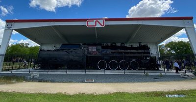

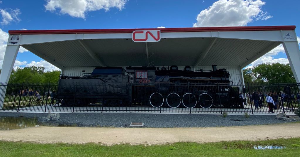

PostPosted: Sun Jun 30, 2024 5:29 pm
Posts: 2893
nowell1 wrote:
Here is a link to a shelter design for CNR #2747 at the Transcona Railway museum in Winnipeg, Manitoba. They are currently fundraising to have this built. It’s a nice design as it provides an unrestricted view of one side of the locomotive(if you ignore the railing) and has a smooth ceiling to thwart nesting birds.
https://www.transconamuseum.mb.ca/
Hope this helps feed the imagination.
Completed:
"Canadian National Railway Company
7h
We are proud to celebrate the official opening of the protective enclosure for the CN 2747 locomotive in Rotary Park, Winnipeg! Built in 1926 at CN Transcona Shops, this historic locomotive was the first steam locomotive to be built in Western Canada in April 1926. Thank you to all who joined us for the ceremony!"
CN would be the last of the Class I's I would expect to spend money on preservation, so good for them: https://www.facebook.com/CNrail/posts/p ... FWmYS4PMjn
449520093_958896902830100_7478820464454185489_nb.jpg [ 102.41 KiB | Viewed 5546 times ]
