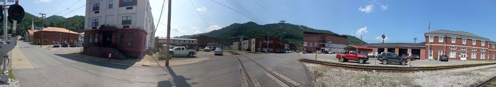

This photo from Wikipedia, attributed to Magnolia677, shows Logan WV as it was in 2014 (click on it to expand). Looks like there is/was a wye there at least. Google streetview would show it now. (This response is also to a question in your post here: viewtopic.php?p=346190#p346190)
Thanks!
Looking at the current satellite view it looks like there is a junction but the third leg of a wye would run right through the center of town.
The building shown on the right in the panorama view resembles a typical C&O station and is now City Hall.

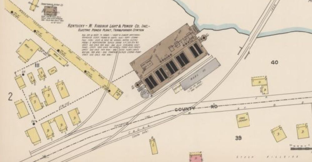

Sanborn fire insurance maps can be an outstanding resource for built up areas and may cover from about 1890 until 1930, sometimes later, and often covering several dates. The Library of Congress has a large collection of them available on line. This is cut from the 1922 map of Logan Co. WV.
https://www.loc.gov/item/sanborn09417_004/

It looks like a switchback there, rather than a wye. Very short tail tracks, probably only one engine and one car at a time could navigate it.
