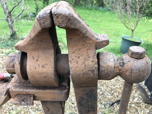

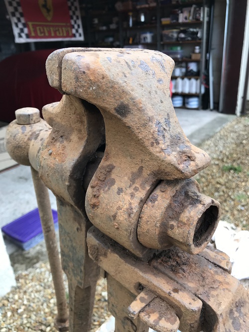

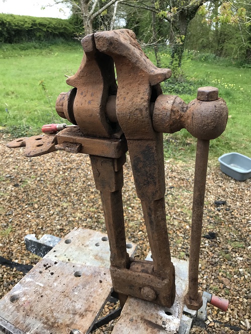

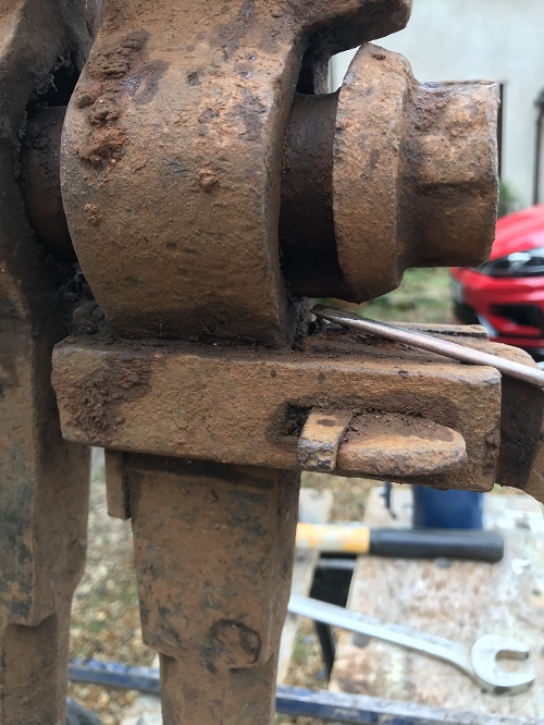

Hi everyone,
I'm new to this forum, and this is my first post, so bear with me. My wife and I have just bought a house in Harton, Shropshire (UK) and back in the day the single branch railway used to run right through the garden where our house now stands. I guess the railway line was removed as a consequence of the Beeching report which saw many small branch lines in the UK close.
The old Station Building is my immediate neighbour, and part of the platform is still there in my garden. The Station building next door is now called 'The Ticket Office' and has been faithfully restored and is occupied by a tenant.
I have found the remains of an old railway truck under a very overgrown tree at the end of the garden where the platform remains, and digging around it I came across the item featured in the photos. Does anyone know what this is? I'm guessing it is railway related - it is very heavily built, has two vice jaws, and the handle is very worn in the hole where it sits. The odd thing is, the handle cannot be turned because it has a 'key' in a slot at the bottom of the hole which prevents it from rotating.
I can supply more details but hopefully someone can shed some light on it for me. Many thanks for taking the time to read this rather lengthy post...
Dave - the Cannon
File comment: Close up of the item I found. It looks like a vice but the jaws cannot be wound open by the handle as you would expect as the handle cannot rotate at all.

It is a blacksmith's post vice. There should be a leaf spring to separate the jaws, there is a piece of it on yours under the clamp with the wedge retainer. The bracket screws to a bench top. The fixed jaw leg goes into a pocket in the floor. Makes for a very rugged vise. The key you see keeps the nut from turning. The screw is probably locked up.
Size of the vise is determined by the jaw length.

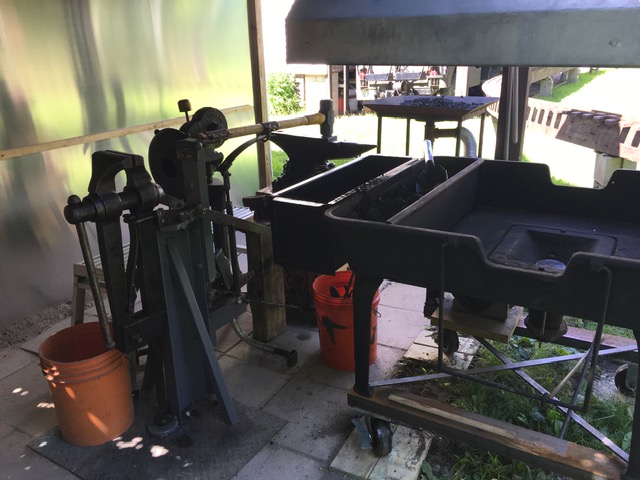

Posts: 110
You can see mine in this shot of my blacksmith shop.

Agree, blacksmith vice. But I must say you have a super cool garden. I dread having to get mine ready for this growing season. But if I had old vices and railway platforms in my garden I might enjoy it more. Cool post by the way, out of the ordinary. Regards, John.

Would one of these have been found in a steam shop, and if so what would it have been used for? I could see it being useful for bending a long piece at its midpoint, say a hand rail or pipe of some sort.

The design uses the long lower 'lever arms' to increase the clamping force and eliminate the need for carefully-machined (and perhaps difficult to maintain) slideways for the movable jaw.

For sure, especially in earlier eras. Blacksmith's vises were commonly found in machine shops in the 19th century, prior to the advent of the parallel-jaw machinist's vise.
The great utility of a blacksmith's vise is that it's designed to be hammered on. The jaws are solid forgings, not castings, and the leg (typically set into a wooden block in the floor) holds it vertically rigid and transmits the force to the ground. This means you can pound away without causing damage.

Posts: 12175
The first thing I said when I saw the photos was "take that damn thing back to my father-in-law's shop and clean up the rust you put on it........."
It's a dead ringer for a well-used, well-abused, and probably-salvaged-ages-ago blacksmith vise in his shop.
