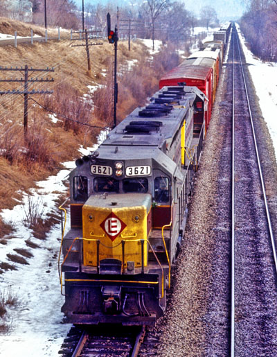

Here are down-on views showing the low profile features. Compare the SD45 fans with the GP35 fans in the top photo.
PC
ELRR-3621-SD45-TWILIGHT-MARION-OHIO-JUL74-P-COOK.jpg [ 98.19 KiB | Viewed 5670 times ]

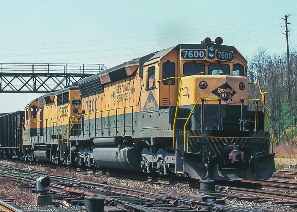

They had to raise the frames on the 45's to get those big fuel tanks under there...
