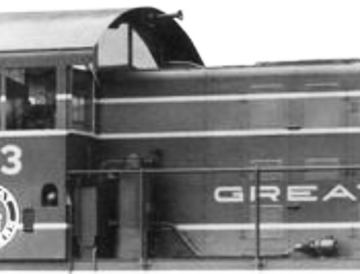

Install a real or reproduction Vapor Heater (pic) for the cooling water. Remove the kerosin
burner for an electric heating element. Heat the cooling water and the fuel tank to 150 F.
Now use vegetable oil (waste or pure) as fuel whatever you get easy to and finished is the
almost zero emmision lokomotive. (I prefer Jathropa Oil - lowest ignition temperature -
highest cetan rating).
And for the ones who real did not want to do anything to the locomotive:
In 2024 you can buy HVO100 = 100% green diesel -> google it.
Just use it as your regular diesel.
