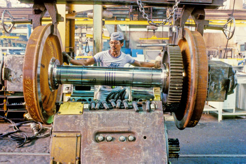

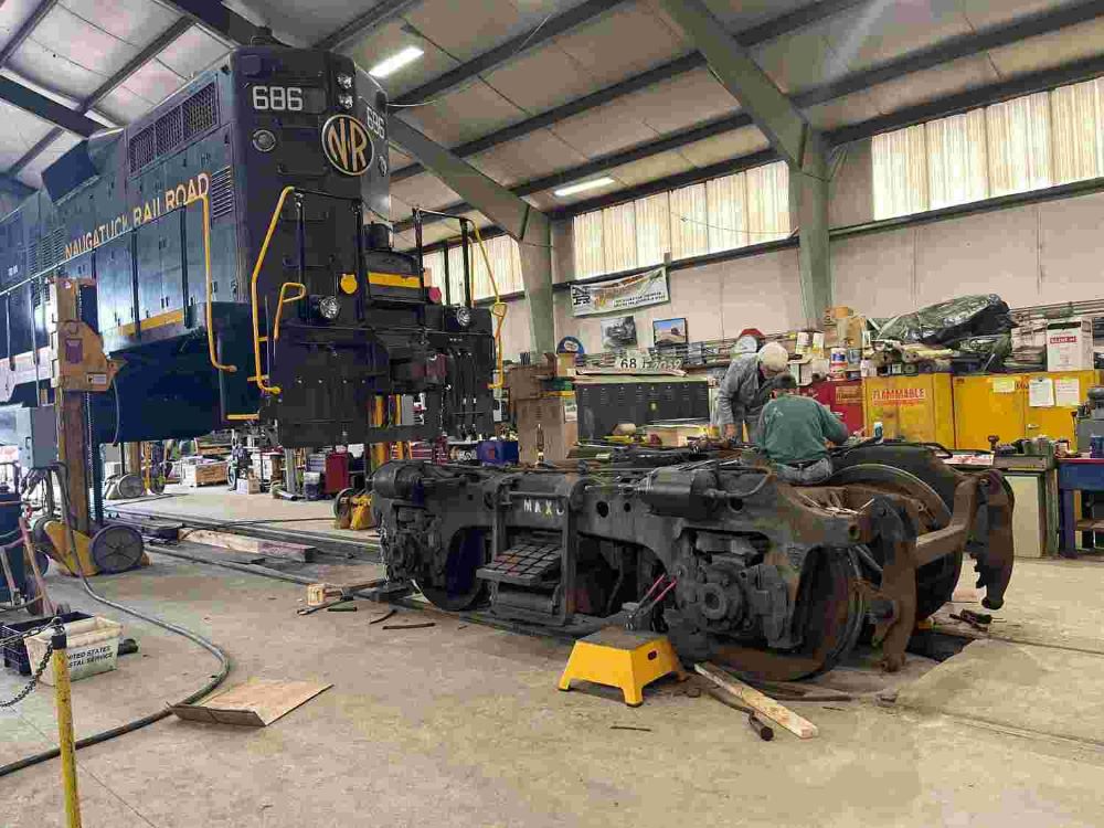

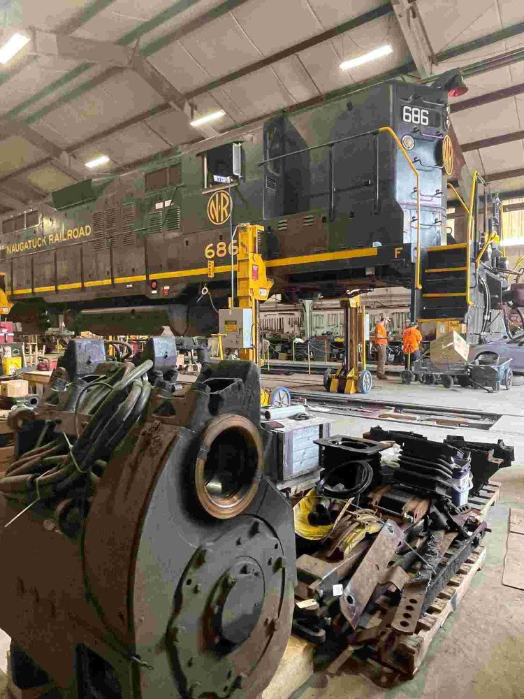

Taken on March 15, 2024 at Thomaston Shop; GP9 686 with both trucks out, getting a D77 combo changed on #2 axle in front truck, and brake rigging replacement on rear truck. Both trucks had brake rigging work done. Four 35-ton Whiting electric jacks are used for this work. There's a rented 15-ton forklift outside moving the heavy pieces around, and a 45-ton Grove hydraulic crane for additional heavy lifting.
The traction motors in the foreground are GE 752 motors, to be used in Alco RS-3 NH 529. With the forklift rented for a week, a lot of motor and combo work was done in that period.
