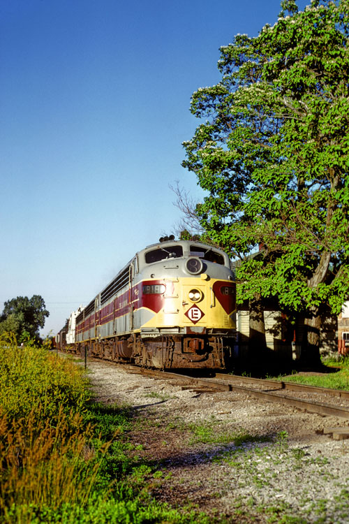

Had a question on this late-1960s program recently. Sharing the information while I have the notebook out. Here is the list of alterations:
1. Steam generators were removed as spares for the remaining units in passenger service, their place was taken by a weight block (usually a steel box of old brake shoes trapped in concrete).
2. The locomotives were fitted with automatic backward transition (a feature standard on E9’s).
3. The traction motors were changed to 15 tooth pinion gears.
4. The traction motors were fitted with larger gear boxes.
5. To accommodate the clearance for the larger gear boxes on the traction motors, the wheel sets were changed from 36 inch to 38 inch (the truck would not accept 40 inch wheels) with 62 tooth bull gears.
6. The brake rigging was altered to suit the wheel size change.
7. The steam cab heaters were changed to hot water cab heat, since there was no steam generator.
8. Changes were made to the MU arrangements to eliminate steam generator related features.
9. The combined fuel/water tank was converted to fuel only, or replaced with a new tank depending on its condition.
E8A Freight conversions by 1975:
809, 810, 812, 813, 814, 815, 817, 818, 819, 820, 826, 827, 828, 832
E8A Locomotives not converted:
811, 816, 821, 822, 823, 824, 825, 829, 830, 831, 833

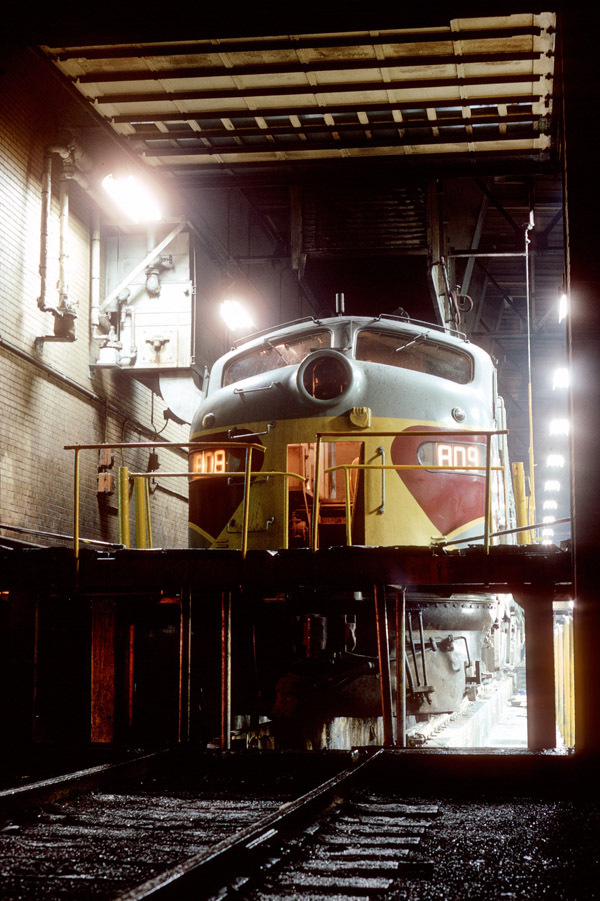

I wanted to add that after they converted the freight units to 38 inch wheels, they kept going and changed the passenger units over to 38 inch as well. That way they only needed to buy one size for the entire fleet.
PC

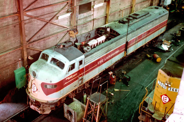

Was any thought given to 'running out remaining life' on the 36" wheelsets in the middle position of the A-1-A trucks (by shimming the inner equalizer ends?) There are several notable (and, seemingly, not unsuccessful) uses of a smaller diameter wheel in the central position of this type of truck, and I'd expect that a 36" set even with bull gear still installed would run fine in that middle position.
 Post subject: Re: Erie Lackawanna E8A Freight Conversion Program
PostPosted: Fri Feb 23, 2024 2:34 pm
Posts: 2130
If I remember correctly, there was an active wiring conflict between trainlined boiler separator blowdown on E8A units and trainlined ground relay reset on later freight locomotives. If the E8A had been the lead unit in a mixed lashup and the fireman rode with his foot on a still active left side panel, holding a button down continuously could have overheated the ground relay reset coil on another unit.
Since the remaining passenger units were in commuter operations at several locations, I think they used up 36 inch wheels on units at one shop.
I wish I could remember more clearly but it was half a century ago..............

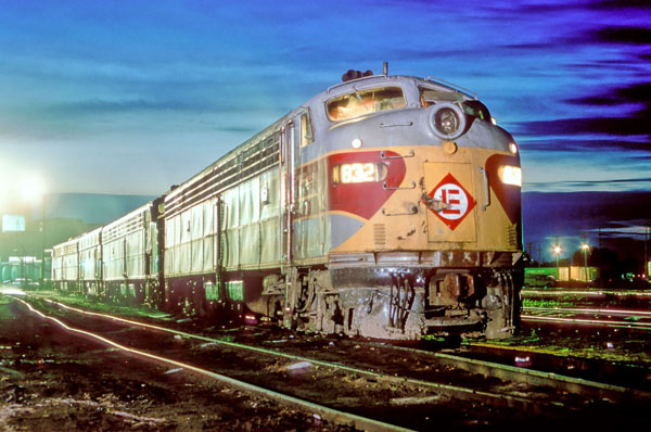

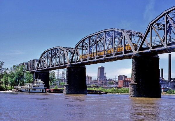

Thanks Sammy. Just to be consistent I'll post some Union Pacific E-units too.
PC
