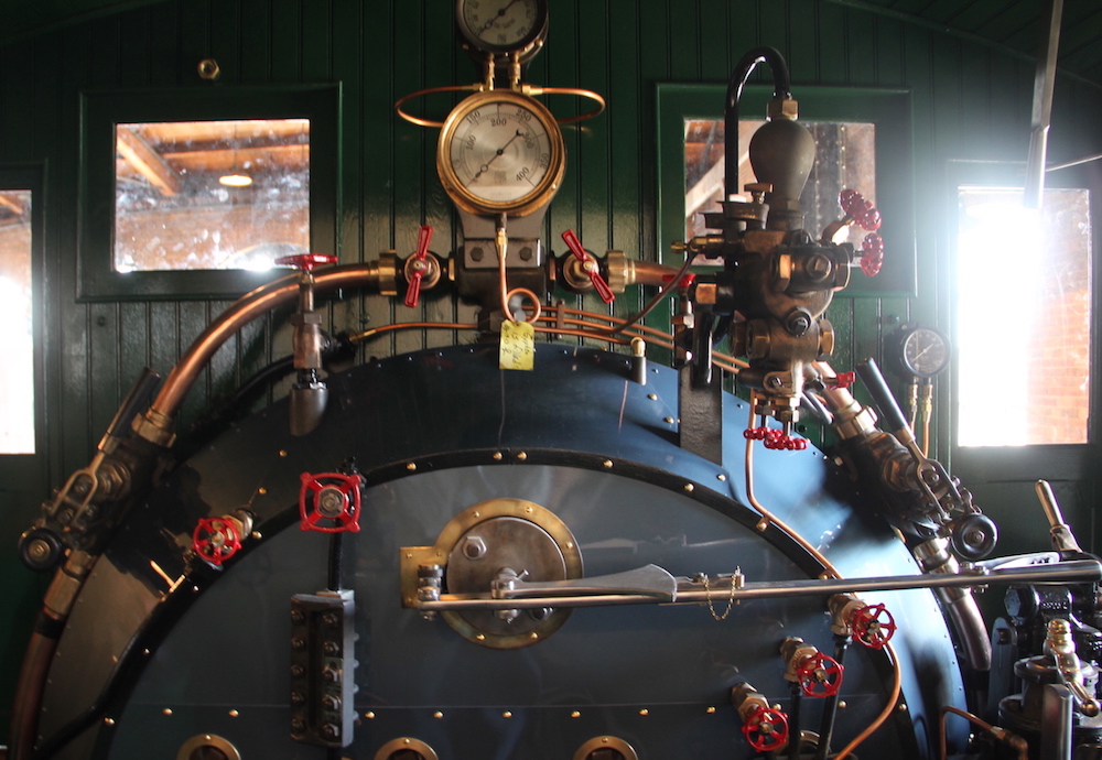

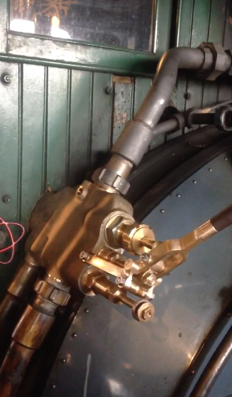

Detroit & Lima Northern #7 at the Henry Ford does indeed use Metropolitan Injectors. It came with two consecutively serial numbered (7 D if I recall correctly) and I've been informed a brand new injector has been recently replicated.
File comment: Originals, photo from 2013
File comment: Replicated Injector.

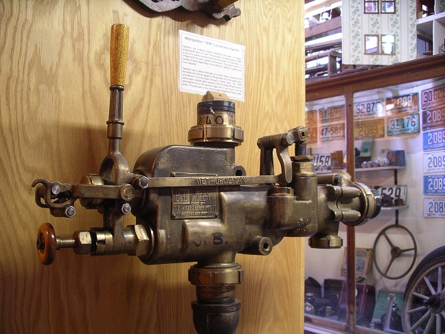

Mine has a wood handle for the lever and somewhat intricate brass handles on the valves. It has a big tag on both sides listing the size and "1898" in large numbers.
The interesting thing is that someone must have had plans to save this thing when it was removed. They removed all the brass pipe coupling nipples and kept them with the injector.
Also, this unit has a valve on what I believe is the overflow. Is that typical? I will see if I can post a picture tomorrow.

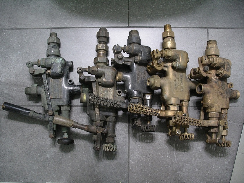

I saw this 18-1/2 O at Heritage Acres museum, Saanichton, BC, in 2009.
I collect smaller size injectors for various projects, like these 6-1/2 O's.
Some are NOS. One has a Porter 2H size tag.

Could you post a picture of the Porter 2h tag?

Slightly off topic on the Henry Ford loco. Why was the decision made to change the live steam line to steel with the replacement injector..? That and the large union seem like a step backwards in the effort to recreate a historically accurate 19th century Baldwin loco.
Definitely not knocking the museum down with their beautiful locomotive, but very curious about that decision.
