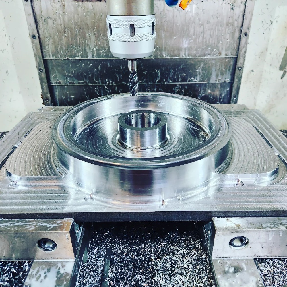

Hello, I wanted to post an update on Scranton Transit trolley #505, our 1929 Osgood Bradley Electromobile. The car body recently returned to Scranton after several years in Honesdale. This latest phase saw the completion of approx. 100 fabricated parts, including the installation of flooring supports and sill troughs for the electrical.
Restoration on the car’s original trucks is progressing, including new 26” wheels from McKees Rocks Forgings and axle work by Lyons Industries. Our volunteers spent a good chunk of 2023 rebuilding the truck frames. The trucks will rejoin the car body in early 2024 thanks to a new pair of CNC’d bolster bearing assemblies.

Author:  JeffH [ Fri Jan 19, 2024 1:08 am ]
Post subject:  Re: Update on Scranton Transit #505
I love those CNC milled center plates.
