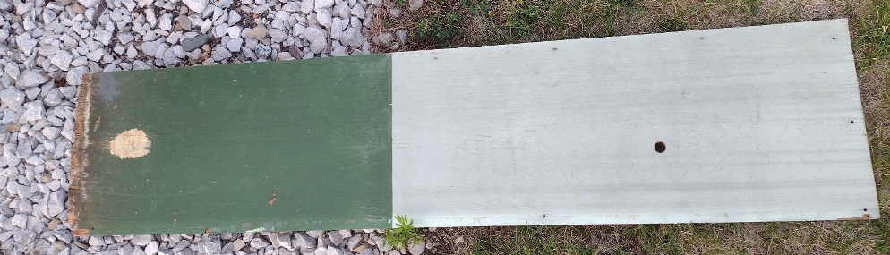

Reviving my own thread.
This is what we found hidden behind some sheet metal the RR installed to protect the wall from from a heater.

Hmm. Our car has light green behind the beige.
