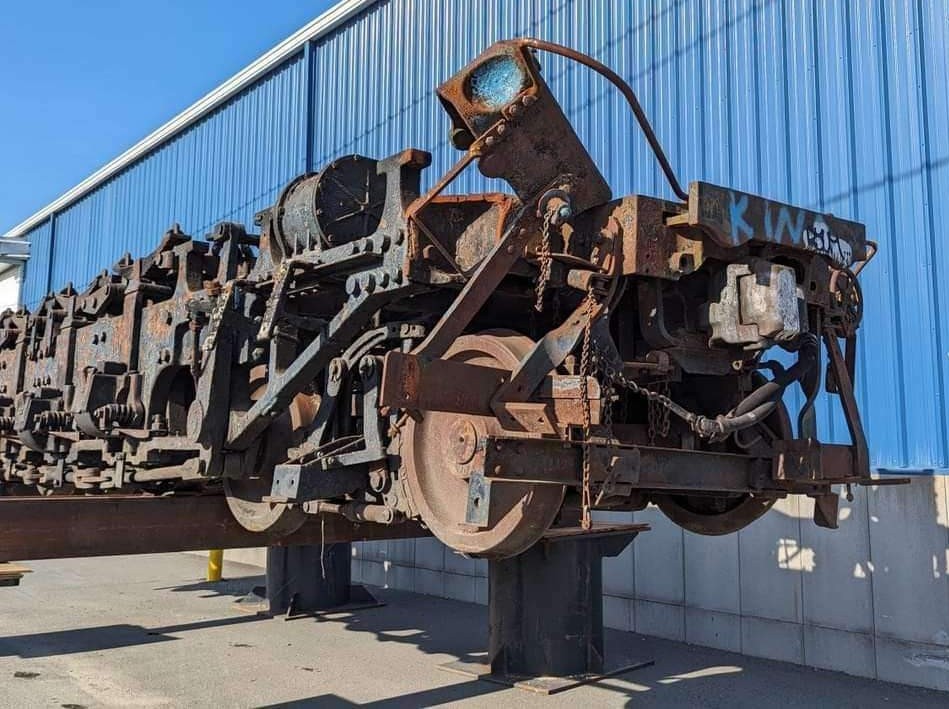

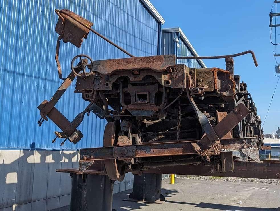

Apparently photos on Facebook have been circulating showing the NYC S-1's frame has been damaged, and the rummer mill says they have been dropped. From the photos I have seen it does indeed look like the has frame suffered damage. Anyone know anything?

Nothing that can't be fixed. Just some bent steel shapes. I don't see any casting damage.
Now I see the fractured poling pocket corners. Looks like a little welding is in order. Those are steel castings, right?

From the posted images it looks like there was some damage to the end sill and footboard supports. Compared to the task of reuniting the frame and carbody, this is minor.

Looking at this with NO awareness of how they were moved, it appears that they were being picked up with slings on both ends, and either the slings slipped out of place and put pressure where they weren't supposed to and cracked the corners, or the movers put slings where they shouldn't have....... but that is 100% my idle, asinine speculation based on my experiences with people who screwed up here and there.....

I likely know even less than you do, but I'm going to say it was some sort of lift damage due to either slippage or improper slinging. What stands out is how the damage seems to be the same at both ends, suggesting similar forces at both ends, and the forces were upwards.
At least we don't seem to be looking at something really serious, like breaking the frame in two somewhere.
The main thing is to hope someone picked up all the pieces. It looks like some things might be missing, judging from the photographs.

The S-1 and T-3 were damaged last winter when Hulcher Service moved the locomotives with 4 side mount boom style dozers, and it appears they were not informed that locomotives could not be lifted by the end sills. If using one of the derailment railroad contactors knowledgeable personnel must be on site to direct them.
