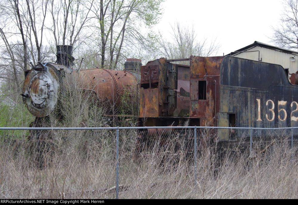

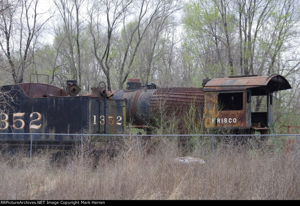

One of the 2-8-2s that they rebuilt from earlier 2-8-0s during WWII. Quite a bit bigger than anything that Valley Railroad already has. Man, the most recent photos I can find of her show that the condition could kindly be described as rough. But, seems like all the basket cases are suddenly having happy endings lately, so why not this one too?

Posts: 2893
Mark Herren photos from 2017, Taylorville IL:
