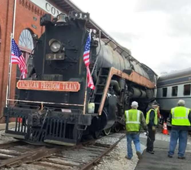

Photo of the incident

I watched that video and it looks like a collision between the loco and the passenger car but on close observation I don't believe the equipment actually contacted each other. They walked that loco through their yard at a snail's pace with observer's everywhere.
I think you might just be right --- The cab roof overhang doesn't look crumpled, and the passenger car doesn't seem to have any divots on the corner. This appears to be "Much Ado About Nothing" (but I wasn't there...)

There was definitely contact between the two pieces of equipment. If you watch closely, you can see the passenger car rock away from the camera a bit. What a dumb mistake to make.

I believe the passenger car is a PRR P85l, converted from a Budd 21-Roomette sleeper. They have the distinction that every other row of seats has no window. Amtrak didn't want them so they fell into commuter service, got HEP and went to the B&O Museum from MARC. They still have no window for every other row of seats.
On a Reading T-1, the frame runs solid to the back of the cab. The back of the frame rests on swivels that rest on the trailing truck and allow the truck to swivel under the frame. The smokebox-boiler-firebox is one assembly that is bolted to the cylinder saddle (cast with the frame) and rests on slides in back that allow for fore-and aft expansion as the boiler heats with the steam pressure.
Thus the cab, moving backwards, does not start to turn until the rear driving axle enters the curve. There is a considerable overhang.

I'd be more inclined to call it "Much Ado About a Minor Glitch". It appears that the engine did snag a grab iron on the coach and after the two were separated the coach was moved a few feet.
Question - In planning the move should the coach have been moved further into the clear? Hindsight answer: Yes. Foresight answer: Maybe. Discussion: As clearly demonstrated in the video other equipment cleared. I'd be willing to bet having watched the video that every measurement they made said it would clear. I can think of three or so reasons none of which are anybody's fault that it did not. Those can be another discussion and yes, brother Woodring is right in retrospect that the prudent move would have been to shove the coach a few feet more or remove it entirely if there was a question.
However, one of the constants in operational planning is the knowledge that, no matter how carefully you prepare, something can, strike that, will go wrong. Therefore, in addition to planning for what you intend to do, you also plan for the things which you can expect to go wrong. One of the things I noticed was that everybody walking alongside seemed to have a particular task - watching the wheels, watching the track, and watching the clearances. There even seems to have been a human flange lubricator assigned. This was all done at slow walking pace. The result was that when the cab did catch the grab iron the movement was able to be stopped and the situation rectified before there was any serious damage (defined for those who have invoked the spectre of FRA oversight as meeting the financial threshold for reporting).
The whole affair is so insignificant as a safety violation that had it occurred anyplace other than a railfan live stream it would be hardly worth the mention.
