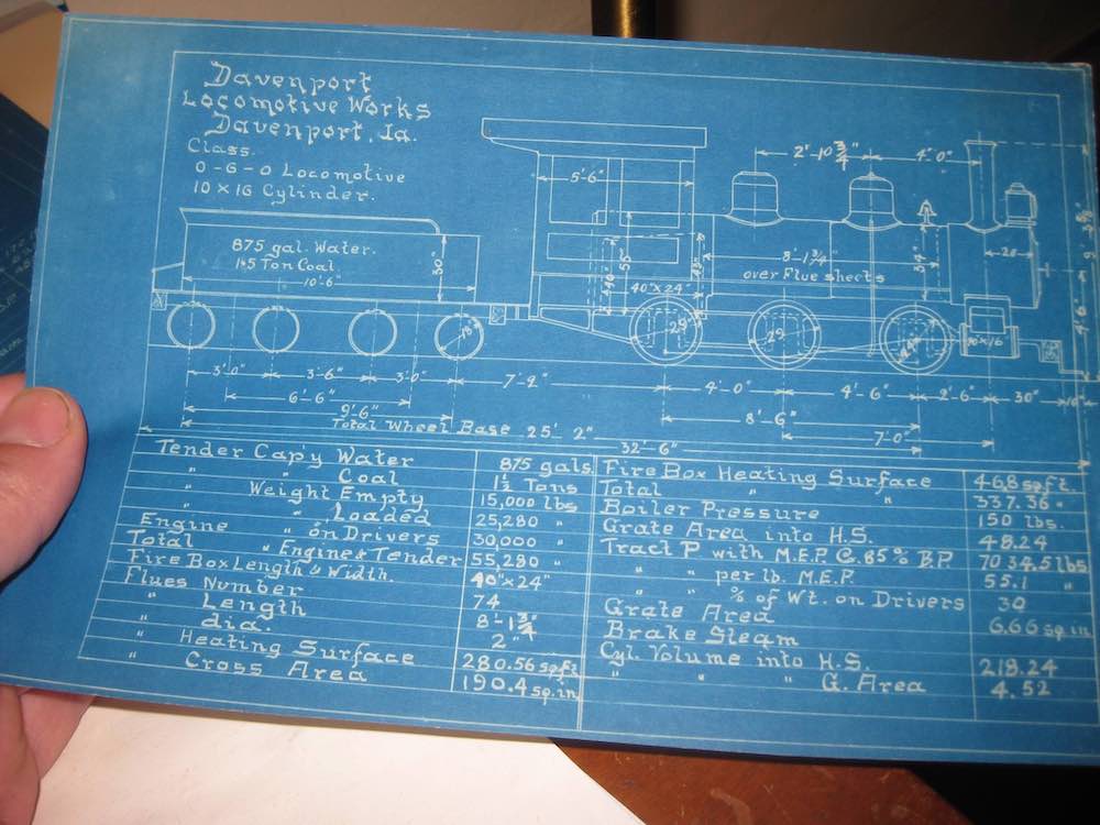

I was able to acquire some Davenport erecting drawings on eBay a few years back, so there are other holdings out there.
This little 0-6-0 is the closest I have to your boiler, with a 34" barrel and 8' 1.75" tubes, so I would imagine it was something similar.
I hope this helps.
-Philip Marshall
