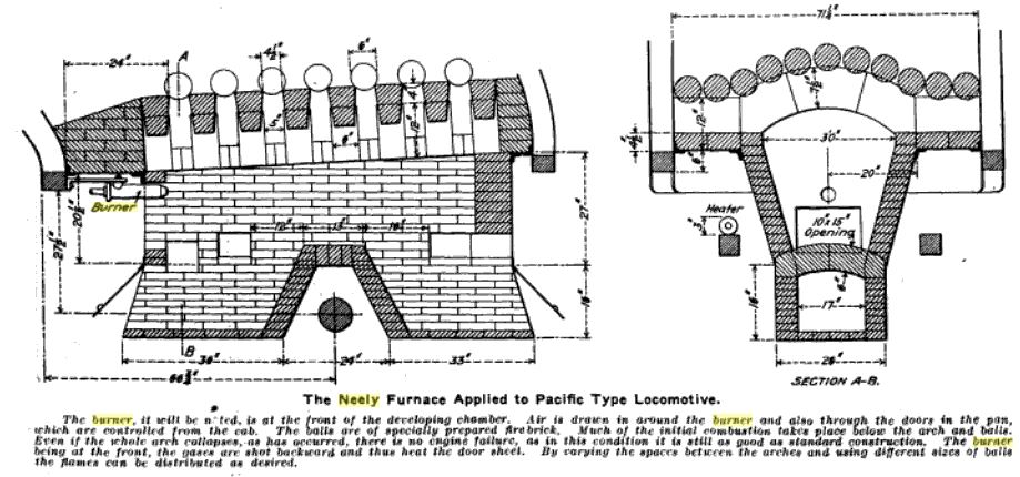

Ive recently fallen across an article from the Railroad Gazette, 1907, which describes the Santa Fe fitting 18 2-8-0's, followed by 18 2-10-2's with a Neely oil burner arrangement. The text of the article seems to imply that this burner arrangement was gentler to firebox sheets and stays, however, I dont recall having seen any mention to this type of burner arrangement before.
Does anyone have any info, drawings or experience with this arrangement? I cant quite tell if it is set up similarly to a drooling type burner, or if the burner was also a different design.

According to the Topeka State Journal of 4 Feb 1907, preserved in the clipping collection offered by Frank Ellington on [] (visited 23 July 2004), "The firebox contains clay balls about 10 inches in diameter. The oil is turned among these and lighted. The clay balls become intensely hot, giving a much more even heat than coal. "
Locobase had not heard of this aid to combustion, and knew no more until he examined the original specs in the DeGolyer volume, which contained the admonition: "Special care taken in drilling tell-tale holes in clay balls so they will be parallel to axis." Walter Bohnstengel later the results of using the "Neely furnace", as this layout was called. The clay balls did indeed "give a desirable flame distribution, but the arrangement was not rigid enough to withstand locomotive service."
Lots more, including cross-section drawings, can be found in The Railroad Gazette, vol. XLII, no. 23, pages 764-767:
https://books.google.com/books?id=-I1MAAAAYAAJ&pg=PA766&lpg=PA766&dq=santa+fe+Neely+oil+burner&source=bl&ots=WCK-QbRSgB&sig=ACfU3U3HoSxrDGM8Cf9JvFZyDWYamGAooQ&hl=en&sa=X&ved=2ahUKEwjw_4uM6deBAxWQlGoFHbjWBfoQ6AF6BAgmEAM#v=onepage&q=santa%20fe%20Neely%20oil%20burner&f=false
- Doug Debs
Neely Oil-Burning Furance Applied to a Pacific Type Locomotive.jpg [ 101.6 KiB | Viewed 3247 times ]

The earliest volume I have read concerning 'oil fuel in locomotives' dates from the early 1880s, and the approach recommended then is very similar: the grate was covered with broken refractory rock, much as a current gas grill might be, and this was heatedby spraying oil on it and igniting with primary air coming up from below. Once this was hot, it served both as widespread volatilization and then ignition of the sprayed oil and as very effective flameholding at low feed rate.
In the Neely system, the initial volatization takes place in the 'developing chamber' which heats the balls from below, and the combustion plume then apparently passes over the tops of the balls for further 'hot' contact. Note that the burner is in the front, comparatively high up, and that the text notes that 'collapse' of the balls does not take the engine automatically out of service but reduces it to the kind of capacity seen in 'ordinary' oil firing... be interesting to see how much of that was observed in ordinary practice.

Has anyone found any patents on this system? I tried a search, but no luck. Tried many different key words. Perhaps the system was patented under another inventor's or owner's name. There were a couple of Neelys involved in steam technology back then, although not railway related. Perhaps this furnace system was developed for other service and then adapted to locos?
With the two lower dampers and a fairly large air space under the combustion/developing chamber, would it have taken a fair bit of skill or experience to make this system work without admitting way too much air? How would it have worked under heavy wheel slip conditions, for instance?
It appears the balls could be varied by size, along with the arch spacings. It really looks like something the back shop crews might have hated!
