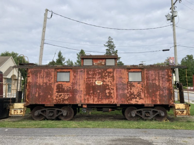

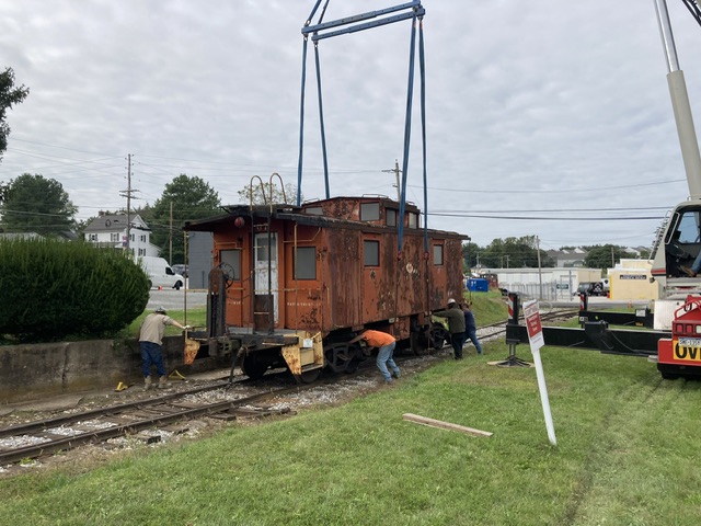

Everything went very smoothly today.
Other than cosmetics, this thing is still in pretty good shape.
Still has coal in the stove!!!
Will post updates.

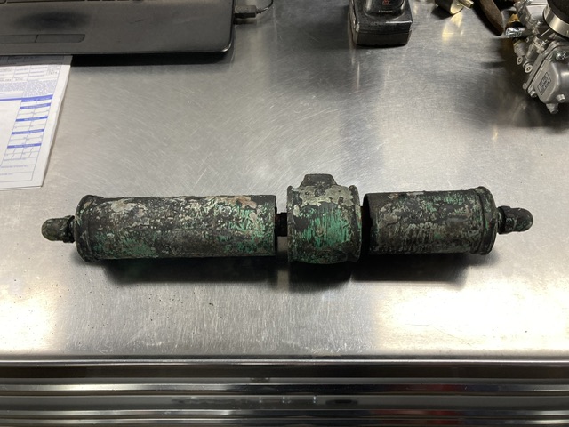

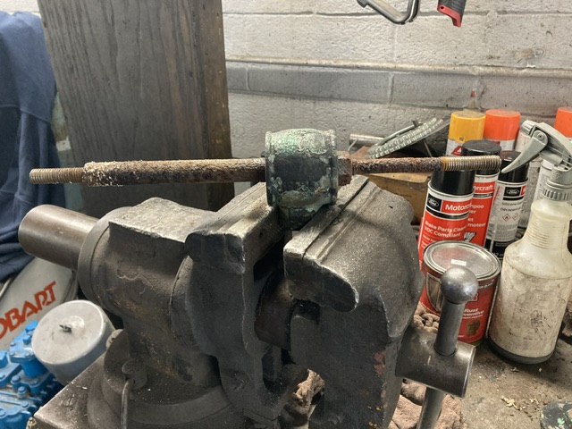

Apparently #67 was used in many push/pull moves.
The caboose would have been the leading end of the train for nearly half of its travels.
The Monongahela RR added a whistle and even a brake stand, with gauge, on this caboose because of its frequent task of being the first car at grade crossings!

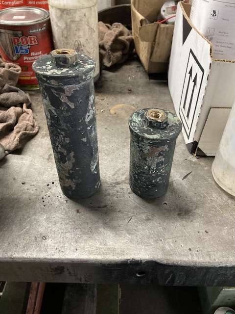

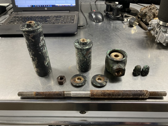

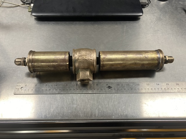

Sorry for the long build up, but here is that whistle. Had to cut through a few coats of paint and repair some damage.
It’s a two chime. That is, two one chime whistles with a common base. It’s the first one I’ve seen like it. But, I’m also relatively new to Railroading… My previous experience is with single or three chime whistles.
I won’t give this one my normal polish treatment. It will live outside and get a nice oxidation patina.
Sounds nice too!!

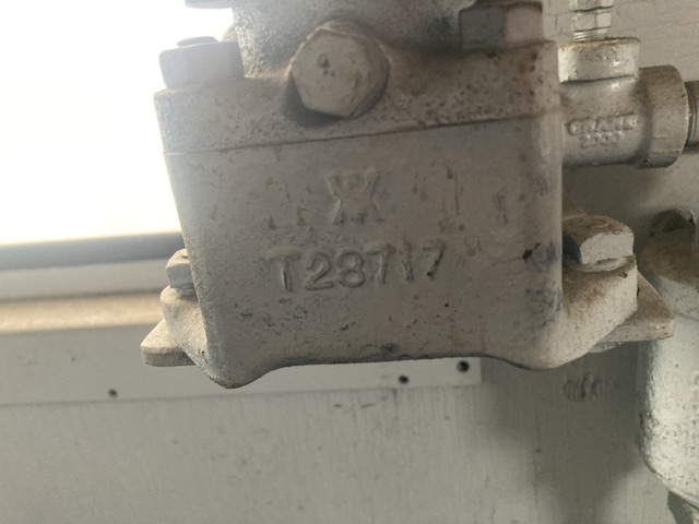

Thanks Eric.
This is a mystery I’ll surely need your help to solve.
I’ll check for a part number on the brake valve. It has multiple positions and looks like an automatic valve in a locomotive.
Need to do more research. Always more to learn.
Mark

Here’s the brake valve setup.
I’ll remove the valve and gauge this weekend. Will get the deadweight tester out and calibrate the gauge. Will also take the valve apart to service it.
Maybe learn more about the brake valve too!

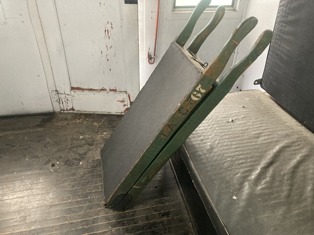

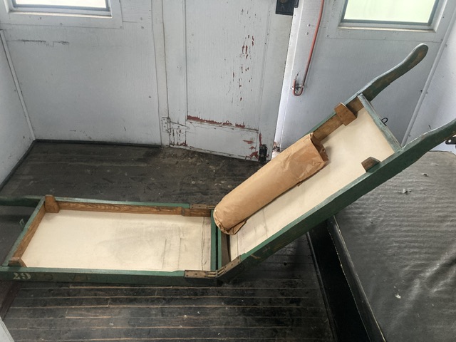

Also found this thing in one of the compartments. Can’t tell if it’s a cot or a stretcher. Still has Monongahela 67 painted on the frame. Looks like it’s never been used. Inside the bag is what looks like a heavy wool blanket.
