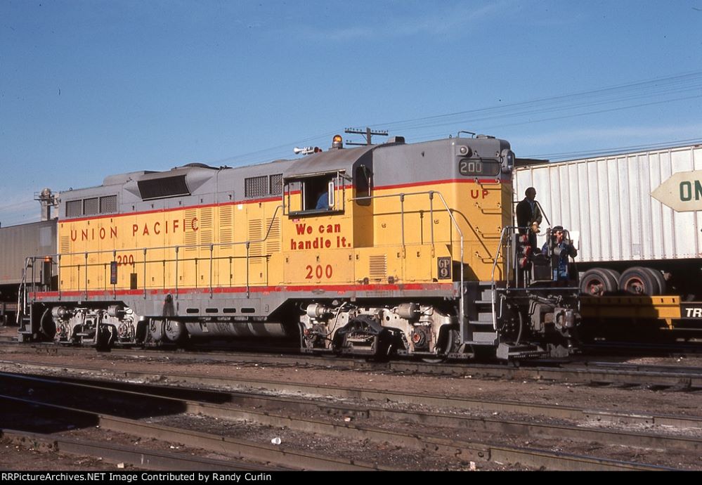

That locomotive is an early GP9, serial number 19201, order number 5321,
frame number 5321-A71 delivered to UP in April 1954 last used as
Indiana Transportation Museum #200 in Noblesville, IN.
Some moons ago it was offered via Ozarkmountain where it is now marked "sold".
Any idea where the lokie go?

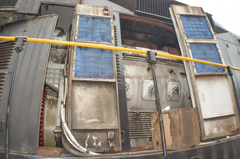

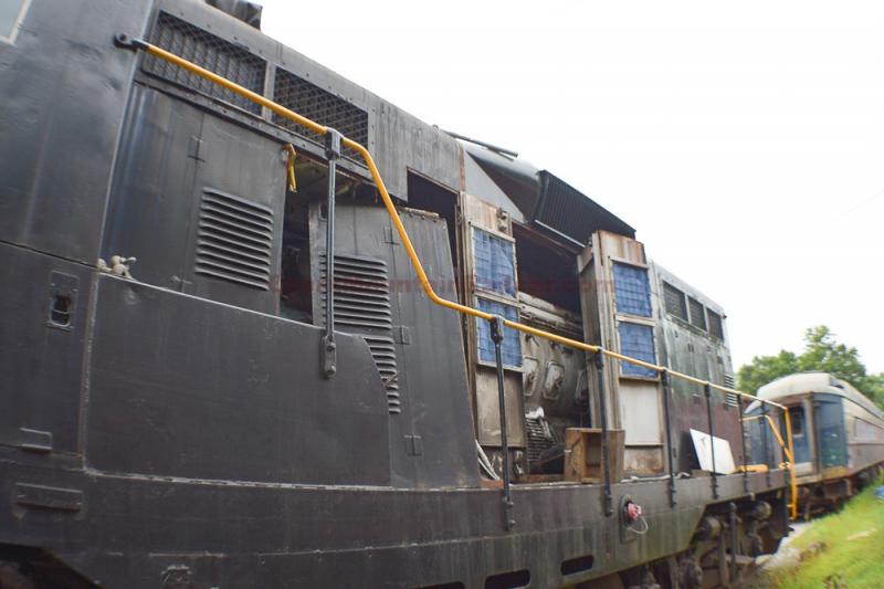

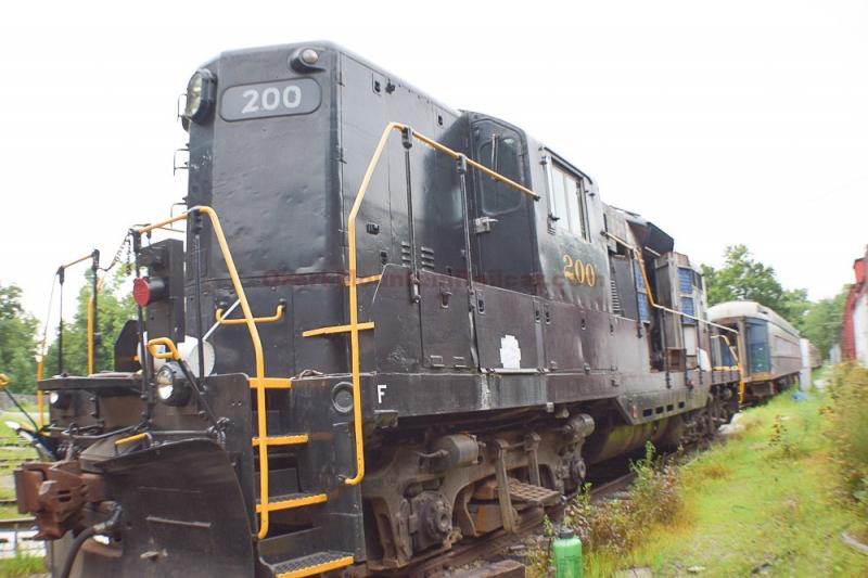

More confusing is when I watch the pics, did I miss something in EMD or UP history?
Show clearly a GP9 but not an 567"C" (no round hole covers)...?

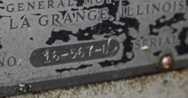

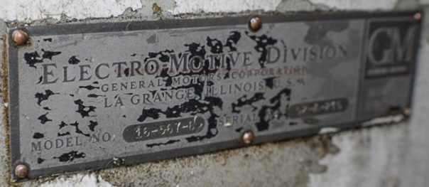

The engine builder plate read 16-567-B with an extra C stamp, so maybe an 567BC?
Somebody know what is behind that story?

That is a replacement engine installed in that locomotive. It is indeed a 567B, upgraded with 567C liners.
That engine UP#200 was built with is engine #54-C-108. I can not quite make out the serial number in the photo to tell you what that engine currently in it was originally in.
 Post subject: Re: Union Pacific GP9 #200 - EMD 567 question - PCook?
PostPosted: Mon Sep 11, 2023 9:14 am
Posts: 2130
Nova55 has it correct.
A 16-567BC in place of original 16-567C, reason unknown.
Engine serial number might begin with "52", hard to tell in photo.

On the right hand side of the locomotive (with the short hood considered the "front") it has GP7 style handrails as well. I wonder if it was involved in an accident at some point.
PostPosted: Tue Sep 12, 2023 7:11 pm
Very early GP9s had the GP7-style handrail post-to-rail connector.
