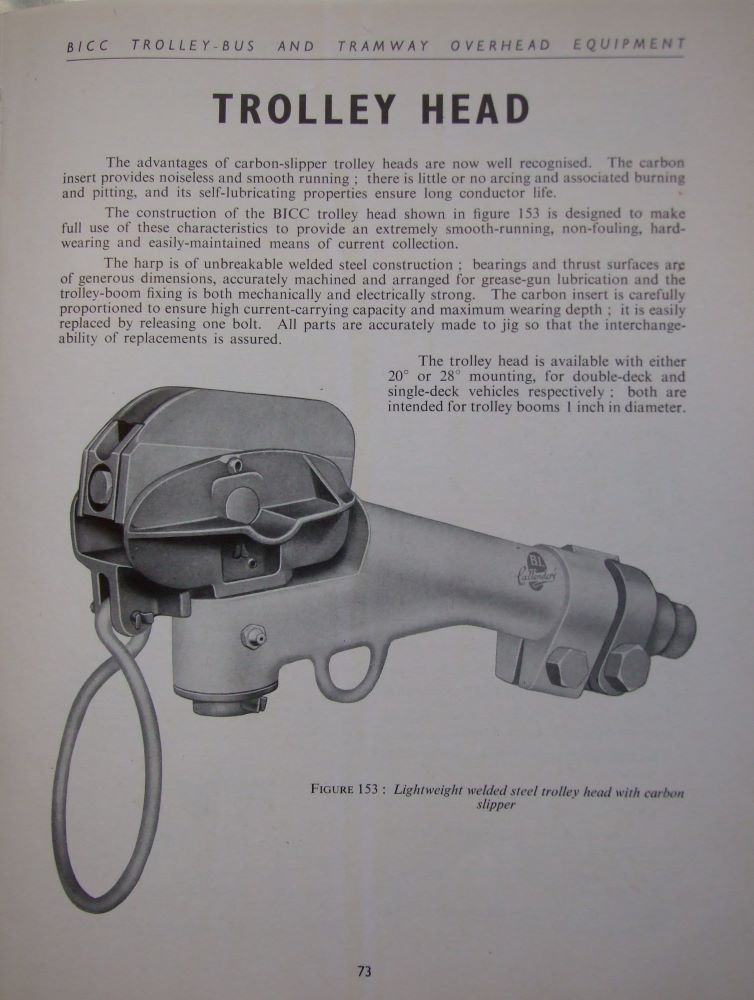

These are pages from a from a late 1940's BICC Tramway and Trolleybus overhead equipment catalogue...
The first paragraph sums up the advantages nicely - though they were known as carbon slipper trolley heads here in the UK.

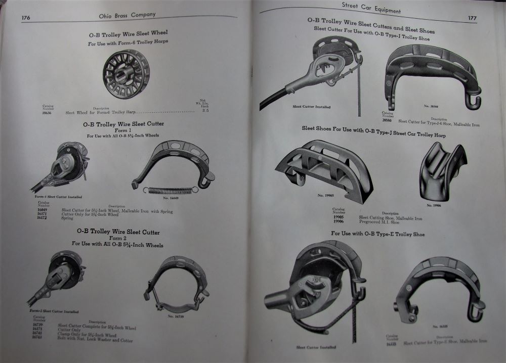

what does an ice breaker wheel look like?
 Post subject: Re: Trolleys vs Shoes
PostPosted: Mon Aug 07, 2023 11:11 am
Posts: 669
Location: Ipswich, UK
From my 1950's Ohio Brass catalogue.....
PostPosted: Mon Aug 07, 2023 8:42 pm
The wheel in the upper left is what was in the sweepers. It's about 20% bigger than the regular wheels the cars used and the running surface was like a ladder with big slots for the ice to fall through.
