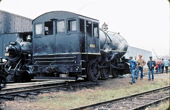

Hi All
The last time I saw a fireless cooker, in operation was at Steamtown when it was still located in Vermont.
It was Oct of 1980 and Railfan's weekend at Steamtown,, the fireless cooker was under steam with one of the pacific's supplying superheated Steam to the locomotive... Pat.
File comment: Photo by Pat Fahey taken from slide.
Fireless cooker # 6816 Steamtown Oct 1980 Photo by Pat  Fahey  #  3.jpg  # 2.jpg
Fireless cooker # 6816 Steamtown Oct 1980 Photo by Pat Fahey # 3.jpg # 2.jpg [ 41.8 KiB | Viewed 19166 times ]
