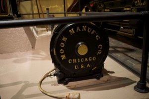

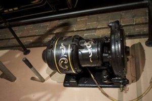

The Willamette c/n 7 at Fort Missoula, MT that we are restoring has a Moon Manfacturing of Chicago, Il dynamo or as Moon called it a "Turbo Generator". It has an output of 110V DC. Which is interesting as in 1923 I would think the standard would most likely be 32 V in a logging locomotive. Also grabbing on to the knife switches in the cab could prove to be interesting. An internet search shows very little information on Moon. Does anyone know of any information or manuals on these. It is complete and only suffering from cobwebs and dust so far.
Thanks,
Larry

It looks like their main business was in the "oil and gas trade" towards the end of the steam era as this original set of ads from the 1940s and 1950s demonstrates:
https://vintageadsandbooks.com/moon-mfg ... -gen-zo869
https://www.ebluejay.com/ads/item/8089084
Here is a 110v model for sale on a farm equipment website, could they have been used in steam threshing machines?: https://www.proxibid.com/Farm-Machinery ... n/51174326
If you go down in this thread, https://www.smokstak.com/forum/threads/ ... or.212474/
it turns out that one is in the "Sanfilippo collection outside of Chicago", they may know something about them.
http://www.sanfilippofoundation.org/san ... ction.html
Go down further, it says that "Moon turbo-gen sets were sold by National Supply and a few others for oil well derrick lighting purposes. A quick test is to connect a 12v battery two any two adjacent brushes. If it is electrically good it will spin as a motor. Don't connect to the output leads. They will run on on air but it takes a lot and you will not be able to run very long. Standard 110/120v incandescent light bulbs will work. LED and fluorescent will not unless designed for DC."
