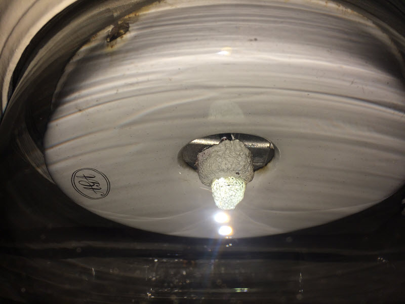

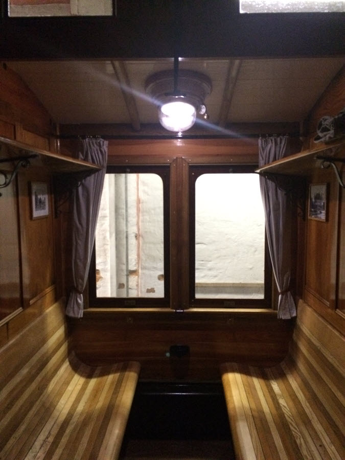

We gave up on this a long time ago. We have created our own LED replacements. You can create your own for any DC voltage with a suitable set of resistors in series.
Odense Nr. Broby Faaborg Jernbane passenger wagon B 27 (In Danish Bee-soo-ah-too) was returned to service from a chicken coop. Originally fitted with gas lamps, the gas flame has been simulated with LED. We are also replacing our cab lights with custom LED fittings.
https://veterantoget.dk/materiel/personvogne/onfj-b-27/
File comment: Close up of simulated gas burner

File comment: Third class compartment B27
