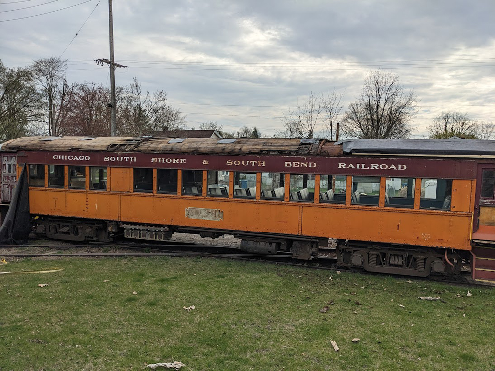

This was posted on the Southern Michigan Railroad Facebook page yesterday:
355865267_653864056780153_2223685039339996042_n.jpg [ 500.04 KiB | Viewed 4408 times ]
356402271_653864133446812_1917925878895840807_n.jpg [ 622.28 KiB | Viewed 4408 times ]
Certainly an unusual approach to such a project.
The SMR commented: "We chose a metal roof to preserve the car without the maintenance required for softer roofing materials."

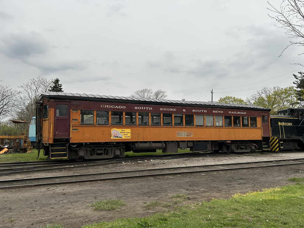

 Post subject: Re: CSS&SB #1 gets a new roof
PostPosted: Tue Jun 27, 2023 9:47 am
Is that a standing-seam metal roof with a central ridge cap, like the roof system used on a building?

Is this an in-service car? If so, how do standing-seam roof systems hold up to flexing and vibration?
