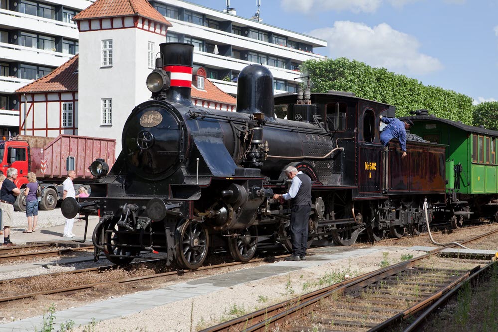

This one

An interior view of the firebox would be helpful.

softwerkslex wrote:
This one
Steven -
Neat looking engine. Was the American type (4-4-0) common in Denmark?

Les Beckman wrote:
softwerkslex wrote:
This one
Steven -
Yes, it was standard up until the first world war.
It is a standard locomotive boiler, superheated, with arch.

The reason I asked for a picture of the firebox interior is so I can see the proportions. Some type fireboxes are better, or worse, for oil firing, and some engines even do better on coal. I won't comment further without seeing the specifics of your locomotive.
