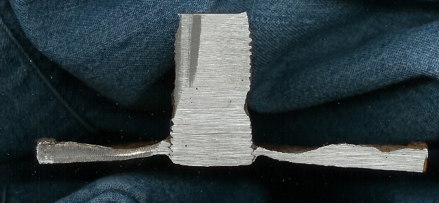

One of the things that I see several folks make a mistake on is firebox sheets. I see the UT reading taken between staybolts. The UT reading should be taken immediately adjacent to the staybolt head, as close as possible with the transducer. The area around the stays will corrode due to stress corrosion cracking, and may be much thinner than the sheet between the stays. Here is a photo of a cross section of a crown sheet and staybolt taken out of a traction engine, which was operating at 150psi until a leak was noticed.
