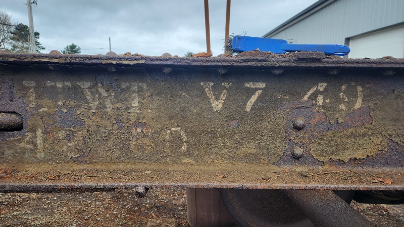

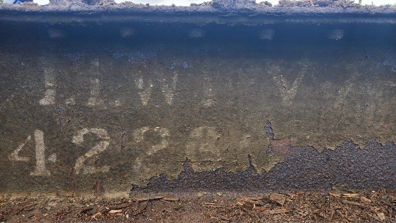

What is the lettering on this weight stencil? Is it LTWT V7 49? I've included both sides.

The car was weighed at station "V" in July of 1949. It weighed 42,260 pounds on that date. Cars are weighed periodically, in order to accurately bill customers, whose shipments are often billed by weight.
"V" would be the telegraph call for the station or town with the scale. Since no railroad is listed, it was probably "V" on the car's home railroad.

Thank you! That would have been about the time it was retired. Are the initials LTWT?

LTWT (LighT WeighT). This is what a light or empty car weighs. Reporting marks (road name and car number) are elsewhere.
You can learn about all kinds of stuff by looking at the rules governing cars of various types. See Rule 30 page 59 for stencils.

This is a caboose. Interesting that its last weight in ‘49 was 42260. When we moved it 3 years ago it roughly weighed 38000 by the readings on the crane. I know in ‘38 it still had arch bar trucks, which have been replaced. When it was moved it didn’t have brakes, cupola seats, stove, water tank and a lot of other accessories. I suppose all that made up the missing 4226 lbs.

Looking at the painted light weight - it is even lighter in the picture that it was when the paint was initially placed on the cars - faded paint is thinner than freshly applied paint.
