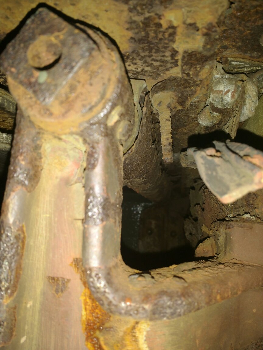

I am digging into the step traps on our troop sleeper. Were these sprung like normal steps or hand cranked? The rotating shaft on ours look to be designed for a handle of some sort.
Does anyone with one of these cars have a working trap?
Thanks
Bill

Looks pretty standard to me...it should just hinge there... It might have a spring to pop it up a bit, but not necessarily...should just lift up and engage a latch to hold it upright.
If it's not been moved in a long time, it's probably stuck or stiff...

The square end is simply for a wrench used to adjust the spring tension. No hand crank.

Never worked on one of these, but my first impression of the square head is it is used to tension the spring.
I see Howard types faster than I do.

To further the discussion a bit, the general trap door practice, but not specifically for troop sleepers, was that the square head was for adjusting the torsion spring pressure after a rounded headed pin was removed (knocked out with a punch) , and was reinserted in one of a stepped series of holes to tighten or loosen the spring tension, as desired. I can't tell 100% but it looks like the head(s) of one of the dowels protruding on the casting. There are at least a couple of troop sleepers restored and on display, maybe more that I am not aware of. There is one at the B&O Museum here in Baltimore (MD) and another at the Mad River and NKP Museum in Bellevue, Ohio. As Pullman built them, there may be drawings and or specification information at the Pullman Library in Union, Illinois.

And the "spring" was not usually a coil spring, but several pieces of flat spring steel that were twisted (by tightening the square nut) to obtain the desired spring tension to lift the trap.

I repaired a similar trap on a car (Salt Lake & Utah 751, Niles Car Co. 1916) at the Western Railway Museum a couple of years ago.
All of the above comments are correct, the mechanism is quite simple. Just knock out the pin and all the parts come out.
The trap on 751 had a broken spring. I purchased new spring steel strips from McMaster-Carr.

I think I can see some of the flat steel springs in one of them where the metal sleeve is rotted away. Since I'm going to have to disassemble steps to replacing side sheet I figure I'll take the traps off and rebuild those mechanisms.
