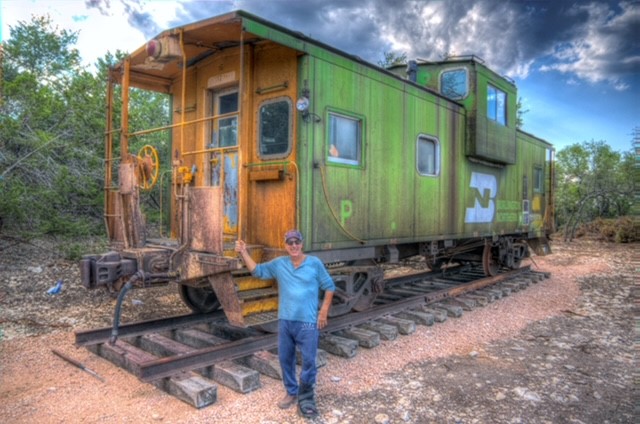

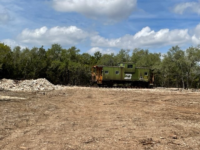

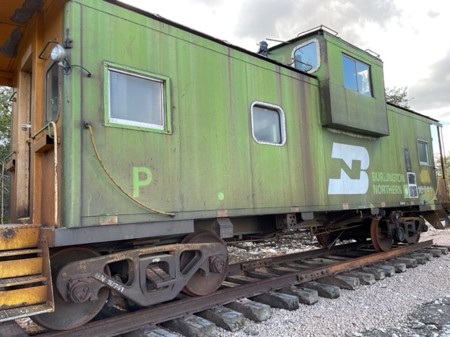

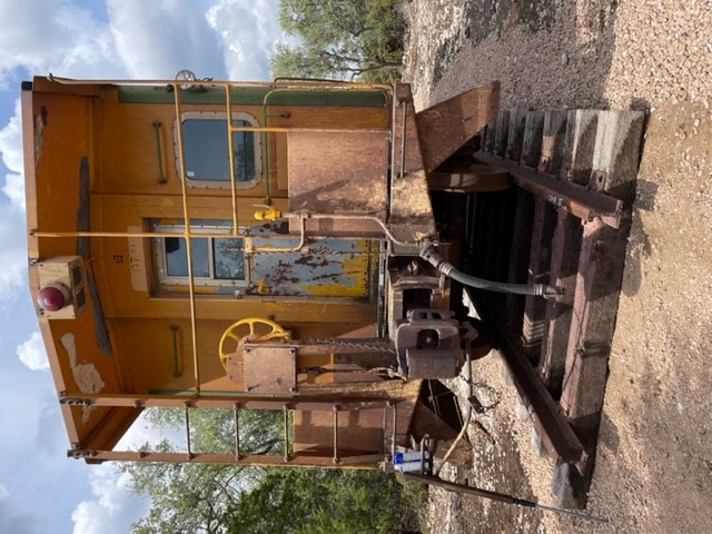

Hi folks, I'm welcoming myself to your forum! Thanks :-) I have been a member of one other forum for the restorations of e9 BMW's and it was/is an awesome experience so I hope to learn-and possibly contribute here as I attempt to restore and repurpose my BN caboose No. 10741. My plan is to rebuild it in much the same way it was intended to be used only with modern amenities in the kitchen and bathroom. Then build an old-school train station like platform around one side of it and use it as a guest house for visitors.
I hope someone(s) can direct me as to the proper sequence of dismantling and refurbishment as well as any potential dangers such as lead paint, asbestos or other safety issues. Also if there are any experts or resources to help me possibly even locally that would be most cool.
The train resides on my ranch in Liberty Hill TX

OK Peter, I'll take a shot at this: First, your way car looks pretty much complete and original in your photos. You might want to keep it as original as possible when you repurpose it. (Then again, you might not...)
It looks like you're in a dry climate, too. I'd start by checking inside for evidence of water damage or leakage, with the idea being that you first want to patch or caulk any leaks, then prime and paint the outside. Otherwise, the work you do inside will continue to require periodic attention until you seal up the carbody. I'm told that John Deere Green is pretty close to BN "Cascade Green", and I can attest to the fact that there were some variations in the actual color of BN equipment. I'm a retired engineman, and this is just about all I know about fixing up an old way car. You most likely already know to watch out for feral hogs, Africanized bees, poisonous snakes, and heat stroke.
Once a month I have lunch with a group of BN and BNSF retirees. There are several carmen in our group, so if you have any questions you want to ask them, please let me know and I'll see what I can do for you.

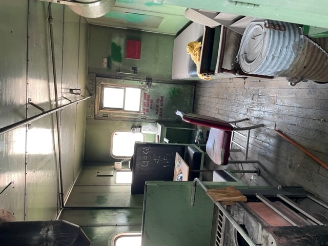

Thanks Sammy, I plan on dismantling pretty much everything but I need to start with the floors since they seem to have a lot of diesel spilled on them. Can someone tell me the best way to remove the flooring and then let me know what's behind the wood paneling on the interior... Is there insulation? Most of the other stuff seems to be bolted on so it should be self explanatory.. I'm posting some interior pictures and will continue as I move along..
Thanks again!

Your way car really DOES look all original and complete. I've seen plenty of restored cabooses and way cars that can't make that claim. Starting with the kerosene soaked wood flooring certainly makes sense, but I can't tell you how best to go about it. Also, I don't "think" there is asbestos behind the plywood, but I've never stripped out a way car myself. If you don't get good answers from somebody on here before then, I plan to go to the big city for a pow wow with some other grouchy old railroaders on January 19, and can ask for you then.

Your car was probably built late enough that you may not be likely to hit lead paint or asbestos on the interior. Further, in an era when so many privately-owned cabooses are gutted completely to serve as party cars, playhouses, guest cabins, or the like, it's becoming increasingly rare to find a completely intact interior in a caboose. So I would resist the urge to rip things apart, or even repaint, unless deemed absolutely necessary. You might, for example, be able to power-sand the original flooring, and if needed replace a couple boards, to deal with the soaked fuel and dirt. (I'm currently dealing with a caboose where a flooring was laid over the original floor by a subsequent owner, came up in cold weather, and now my boots keep getting pulled off by the adhesive until I remember to take along sand or the like the next time I'm there....)

The main place the "newer" cabooses had asbestos was in the heat shield on the wall behind the stove. Other than that, you should be in good shape.
