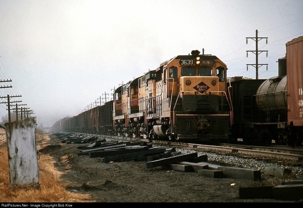

EJ Berry wrote:
Back in the day, cinders were used as ballast on secondary tracks and running tracks.
Here's a good example, Phil. This photo was taken not too long after they removed the interlocking and ripped up #4 Track through Annville...
 Post subject: Re: Coal Ash Disposal
PostPosted: Sat Jan 14, 2023 9:56 pm
Yes, the subgrade under the former Track 4 could be cinders or soil. There were plenty of cinders available.
But Track 2 with the train has crushed rock ballast, appropriate for as heavy a line as the Lebanon Valley Branch.
