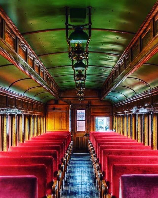

Kelly Anderson wrote:
k5ahudson wrote:
It's a brand new tongue and groove 1 1/2" wood plank floor on the car now. The original was totally shot.
The attachment IMG_0671.jpg is no longer available
Snagged from Google.
All of the Strasburg Rail Road's coaches have plain solid plank floors like you describe, usually painted red.

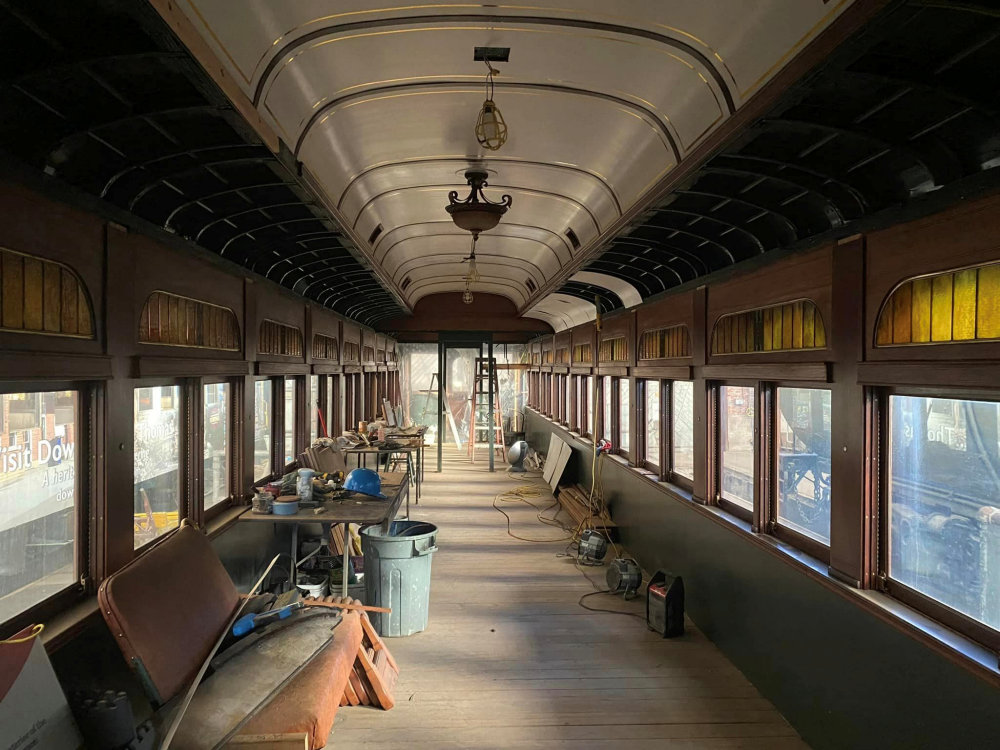

Thanks Kelly, but I think you misunderstood what I meant also. We ripped out the original floor entirely right down to the metal frame. We then relayed a new wood, 1 1/2" thick, 3" wide tongue and groove (maybe 4") from one side of the car to the other (not end to end), just like the original base floor was. That's where we are at now. There will be a 1/4" plywood sub floor installed on top of that. The final flooring will be on top of that. See the attached photo.
